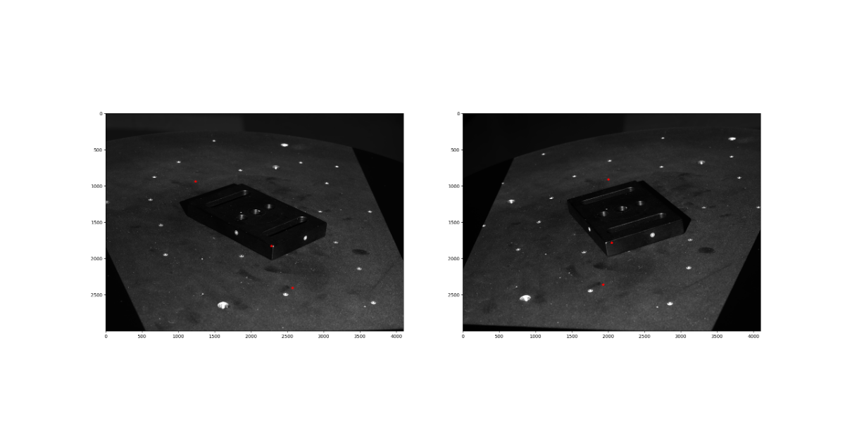

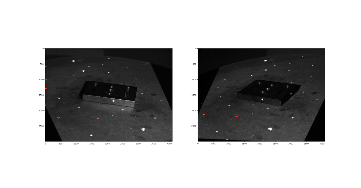

utilize marker locations
I try to make use of the coordinates of the marker locations. As a verification I plot the 2D-XY-coordinates over left and right grayscale image. That works well for every 1st measurement in any .ginspect-sequence, but locations misalign for any next measurement in the file. See examples: M1.png shows correct locations. M2.png is wrong. Utilizing GOMInpsect 2023.
Please help me out. What am I missing?
