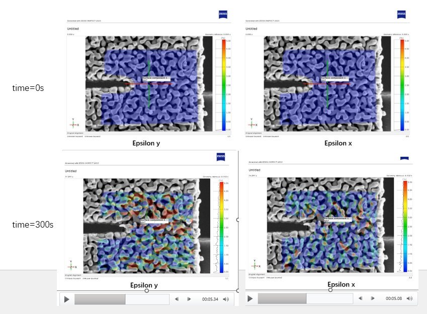

Can I have the strain data of Exx and Eyy at several locations along with the x direction?
I have a notched sample from a tensile test. I'm trying to extract the Exx and Eyy strain data at the same locations along the x-direction with the time/frame increases, as shown below. I'm using a free/trial version of Zeiss Correlate and haven't been able to find a function to export strain data along a defined direction (the x-direction in this case). The left image shows the Eyy strain map, and the right image shows the Exx strain map. Can anyone know how to do this please?

Hi Quinggou,
you can create section along the x-axis, inspect them for strain Exx, Eyy and export the diagram data.
Hope this helps.
