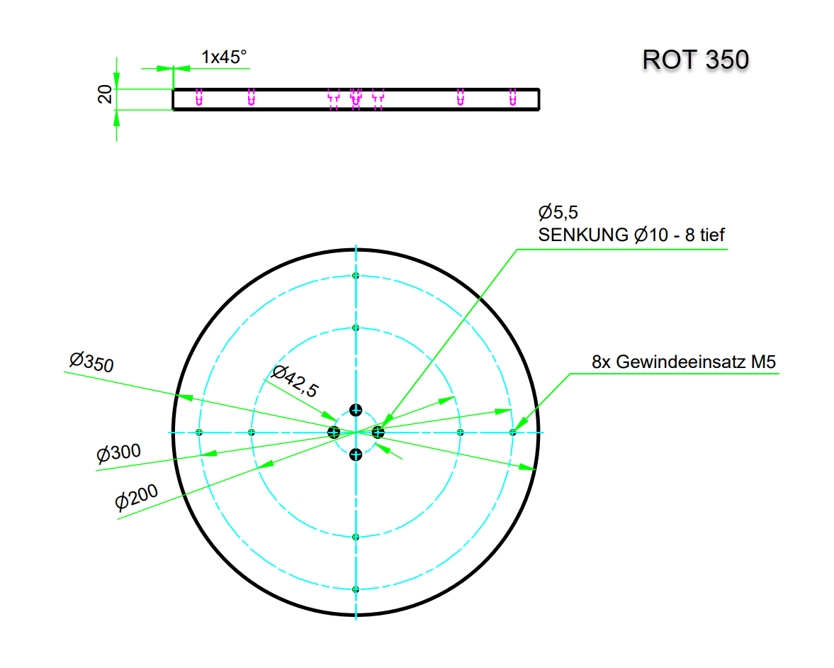

[Au...] Posted June 2 Share Posted June 2 Hi There, I have a 350mm rotation table but I cannot find anywhere what the specs are for the screw holes to mount parts to the turn table. What I am looking for in the specs are as follows: What is the threads of the screw holes? Metric or Standard and what size. The depth of the screw hole so I know how long of a screw to use that wont damage internal components. Distance between sets of screw holes - See below for the distances of each black line. Link to comment Share on other sites More sharing options...

[Ax...] Posted June 3 Share Posted June 3 True, this holes are metric screws M5. I simply drilled more threaded holes into the plate to optimally position my mounts. However, you should unscrew the plate first. Otherwise the shavings will be in the housing and could possibly cause short circuits on the controller. If you have screws near the center, they must not be too long, otherwise the gearbox housing will be damaged. There is space further out towards the bottom. Link to comment Share on other sites More sharing options...
[Na...] Posted June 3 Share Posted June 3 Here you are 🙂 If you need full drawings or even the CAD for construction please contact your support and we can hand them out. Nanno 1 Link to comment Share on other sites More sharing options...

[Na...] Posted Tuesday at 12:59 PM Share Posted Tuesday at 12:59 PM Hi, the drawing will be added in a revision of the manual 👍 2 Link to comment Share on other sites More sharing options...
