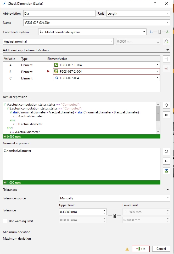

I am trying to choose to report the circle without an error, and if they are both calculating, the closest to nominal.
But if the inputs contain a un-computed value the whole result will also be un-computed, is there a way around this?
Thanks in advance,
Nyall
image.thumb.png.c4249844ec8234610c92079925c297dd.pngimage.png.706f583635e1f943ab96ca86848a515e.png
I think I have the solution... if anyone else comes across a similar  issue, the proper test for if an element is uncomputed is:
x = "???"
if  A.actual.computation_status != INVALID:
    if B.actual.computation_status != INVALID:
        if abs(C.nominal.diameter - A.value) < abs(C.nominal.diameter - B.value) :
            x = A.actual.diameter
        else:
            x = B.actual.diameter
    else:
else:
    else:
        x = "???"
x
