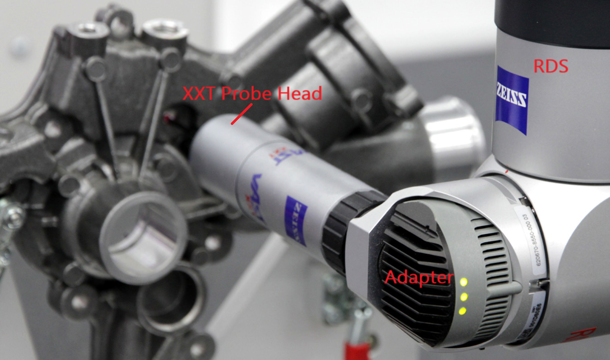

[Jo...] Posted yesterday at 04:08 PM Share Posted yesterday at 04:08 PM Has anyone ever had the adapter portion of their RDS system be an issue? Like it was swapped out and everything was ok? In regards to intermittent and irregular or stuttered indexing. More likely the RDS? The adapter has quite a few flesh wounds. ⚔️ Thanks. Link to comment Share on other sites More sharing options...
[Cl...] Posted 11 hours ago Share Posted 11 hours ago How old is yours? How many collisions has it endured? What You describe could possibly be a stripped aluminum gear, or a bad bladder. Link to comment Share on other sites More sharing options...
[Jo...] Posted 10 hours ago Author Share Posted 10 hours ago 2012 Contura. RDS and adapter original. The XXT probe has been swapped out at least 2x Link to comment Share on other sites More sharing options...
[To...] Posted 10 hours ago Share Posted 10 hours ago (edited) Please sign in to view this quote. This RDS is CAA capable. Does it have a bladder? Edited 10 hours ago Link to comment Share on other sites More sharing options...
[Cl...] Posted 8 hours ago Share Posted 8 hours ago (edited) I thought all XXT's did. The gear that rotates the XXT is aluminum and strips out rather easily. Edited 8 hours ago Link to comment Share on other sites More sharing options...
[To...] Posted 7 hours ago Share Posted 7 hours ago (edited) Please sign in to view this quote. You may be right about that. I believe the first version of RDS did use an air bladder but now I'm not sure the purpose of the air bladder. My assumption was it used the bladder to push the RDS adapter plate away and rotate the RDS. The speed knob would not control the speed of the index. Once it started, it was going full blast until it got to the desired position. You were also able to rotate the A and B a full 180° in either direction. The current versions, are motorized and controllable with the speed knob and the B can only rotate approximately ±165°. I am questioning my understanding of how both systems work now. lol Edited 7 hours ago Link to comment Share on other sites More sharing options...
