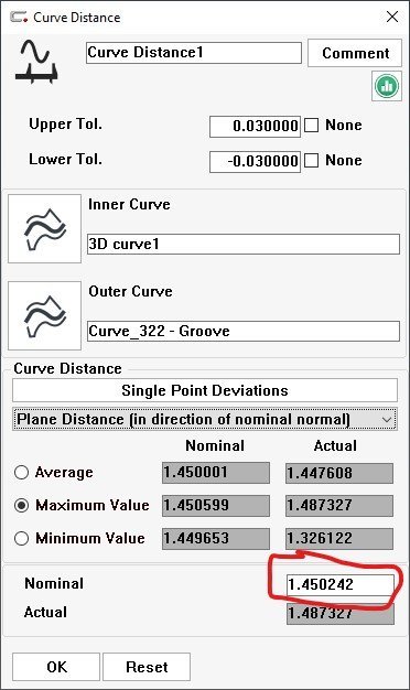

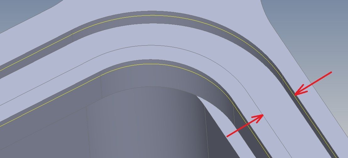

[To...] Posted June 9, 2025 Share Posted June 9, 2025 (edited) I am measuring face groove that has a line profile callout for the outer side of the groove and then a specific groove width with a ± tolerance. I'm looking for ideas to measure the groove width. Is there something I do with 2 curves, i.e. Curve Distance? Edited June 9, 2025 Link to comment Share on other sites More sharing options...
[Ma...] Posted June 9, 2025 Share Posted June 9, 2025 There should be distance of curves - maybe you would need to break them into separate ones to obtain width on each side. You are selecting inner and outer curve there. 1 Link to comment Share on other sites More sharing options...

[To...] Posted June 10, 2025 Author Share Posted June 10, 2025 (edited) Please sign in to view this username. I assume I will need one set up for the Min and one for the Max. What about the dropdown menu? Plane Distance? Is Nominal a user input? Does Inner and Outer refer to their physical location or does one refer to being a reference? Edited June 10, 2025 Link to comment Share on other sites More sharing options...
[Ri...] Posted June 10, 2025 Share Posted June 10, 2025 Please sign in to view this username. I typically input the nominal myself, it should be extremely close, if not something is wrong. As for the direction, I typically do Plane Distance, so that it is forced to be a 2d distance according to the normal direction of the curve(s), but I could see some cases where 3d distance would be better. And yes, you will have to make one for the Min, and Max if you want a reported value, kind of a bummer. 1 Link to comment Share on other sites More sharing options...
[Ky...] Posted June 10, 2025 Share Posted June 10, 2025 Curve distance can be a bit tricky to get working in my experience. First rule is to make sure that the curves are going in the same direction (e.g. both counter-clockwise or clockwise, but not one each). Without that especially the max value can be way off. Second, it usually works best if they start about the same point. I don't think it is 100% necessary, but it helps. Also, about the same number of points is helpful too. I usually evaluate it as "Plane Point". The direct 3d, in my experience, can have projection errors so it is sometimes a bit larger than it should be. The nominals are rarely right on, but reasonably close. The higher the density, the better I think, but of course you do have to be within reason. You'll be there all day if you are trying to do 200000 curve points. 2 Link to comment Share on other sites More sharing options...
[To...] Posted June 11, 2025 Author Share Posted June 11, 2025 Any thoughts on the Outer / Inner question? The help topic is really not clear. Link to comment Share on other sites More sharing options...
[Ky...] Posted June 11, 2025 Share Posted June 11, 2025 The inner curve is the reference. It calculates a distance starting at each curve point of the inner curve to a corresponding intersection point on the outer curve. Either way works, but they will likely give slightly different numbers. 2 Link to comment Share on other sites More sharing options...
