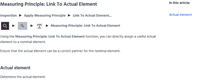

[Ge...] Posted June 10, 2025 Share Posted June 10, 2025 Can someone provide a deeper explanation of this measuring principle as it pertains to the attached example. Link to Actual.pdf Link to comment Share on other sites More sharing options...

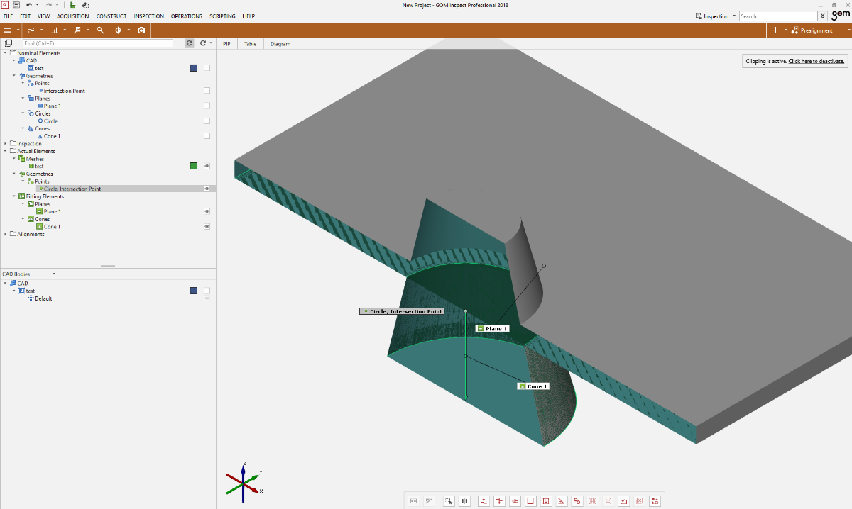

[Aa...] Posted June 11, 2025 Share Posted June 11, 2025 (edited) Gerald, I tried to make a similar construction. But I'm not sure if I understand fully the issue. I'm using GOM 2018. Edited June 11, 2025 Link to comment Share on other sites More sharing options...

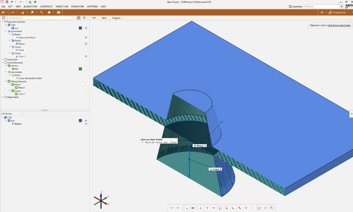

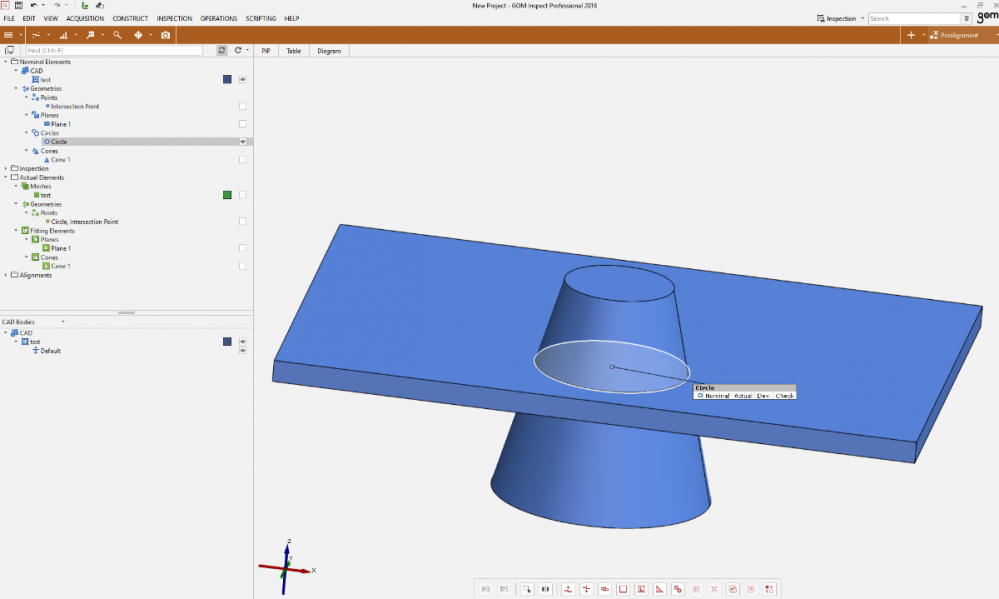

[Aa...] Posted June 11, 2025 Share Posted June 11, 2025 (edited) Using the above, if I were to measure or create actual elements on a perfect sample scan, we would see something like what is shown below. The measuring principle for the Cone 1 and Plane 1 was "Fitting Element". The measuring principle for the Intersection Point was "Referenced Construction". And finally, I used "Link to Actual" as the measuring principle for the Circle --linking the nominal Circle to the actual Intersection Point. Notice how GOM re-auto labeled the actual intersection point as: "Circle, Intersection Point". Edited June 11, 2025 Link to comment Share on other sites More sharing options...

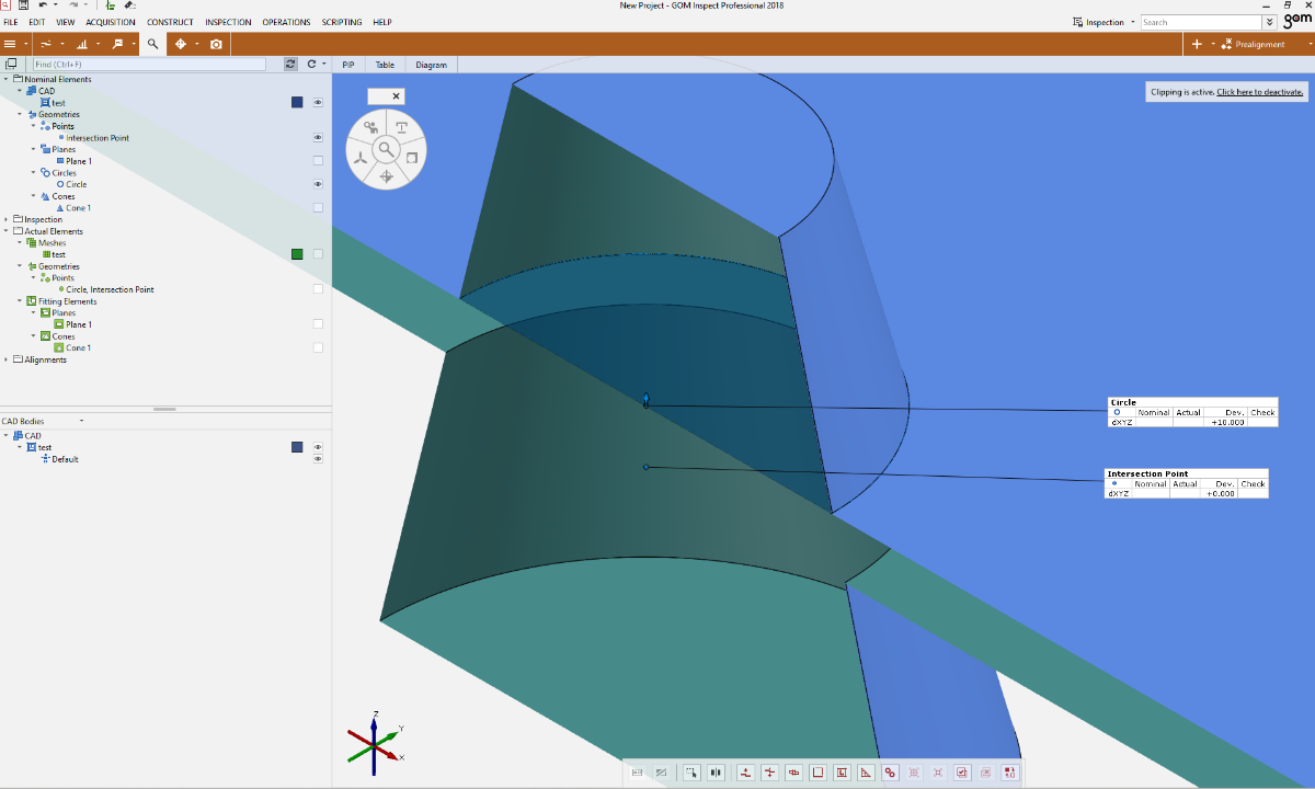

[Aa...] Posted June 11, 2025 Share Posted June 11, 2025 Now if I were to check deviation between the nominal location and measured actual location for the Circle, there is a deviation of 10mm, which was the thickness of the square slab. So even though I'm measuring a perfect scanned sample that exactly matches CAD, I'm still getting a deviation. On the other hand, if I were to check the deviation between the nominal and measured actual locations for the Intersection Point, I get 0mm of deviation. Link to comment Share on other sites More sharing options...
[Aa...] Posted June 11, 2025 Share Posted June 11, 2025 To answer your question, I think you probably want to modify your construction slightly before applying the "Link to Actual" measuring principle. Or maybe use a different strategy depending on what the goal is. Link to comment Share on other sites More sharing options...
