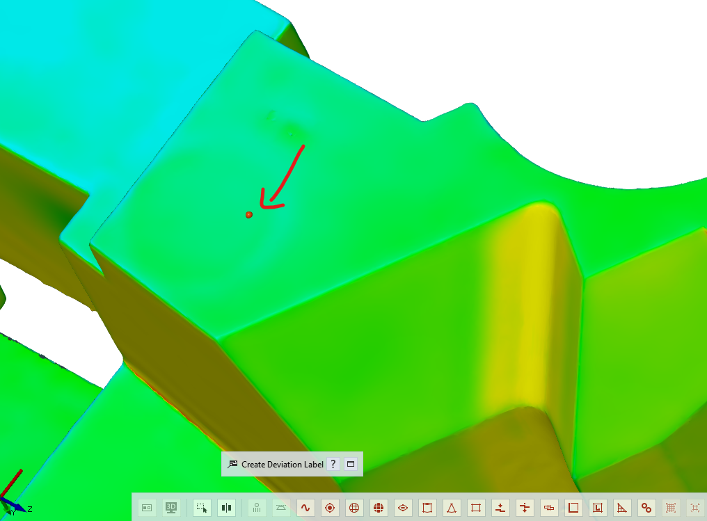

[Yi...] Posted June 11, 2025 Share Posted June 11, 2025 Hi, I'm encountering a really strange problem in one of my many programs, and that is that when I want to place a deviation label on a color map, the software does not show me the deviation value in real time, but only a point. Only then, by changing the display settings, am I able to display the measured value. I've tried all sorts of ways and I can't get the situation back to normal. Can you please point out to me the source of the problem and what is the setting that controls this issue? Many thanks Link to comment Share on other sites More sharing options...

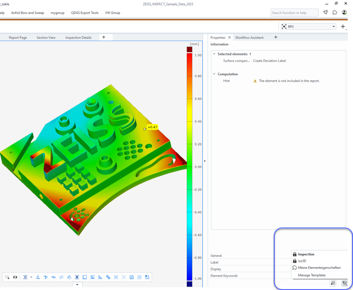

[Na...] Posted June 11, 2025 Share Posted June 11, 2025 Hi, I guess this is an older project? They sometimes overwrite the standard properties for new elements. Please click on one label and set this to "Inspect": The next element of the same type will be created with the "Inspection" template, so with the standard "deviation" label. This setting is saved in the project, so with another project you might need to change this setting once in that project also. Nanno 1 Link to comment Share on other sites More sharing options...
[Yi...] Posted June 11, 2025 Author Share Posted June 11, 2025 Perfect!! Thank you Nanno, Problem solved! I understood it was related to the template but I didn't try under that settings button. Link to comment Share on other sites More sharing options...
