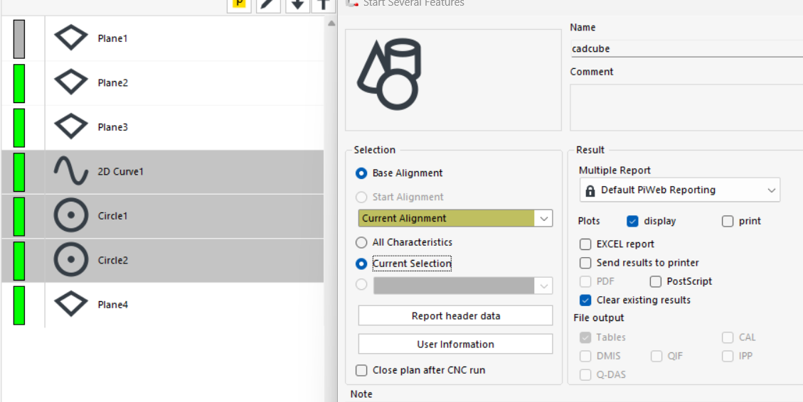

[ji...] Posted June 11, 2025 Share Posted June 11, 2025 Can you run a program starting in the middle? Link to comment Share on other sites More sharing options...

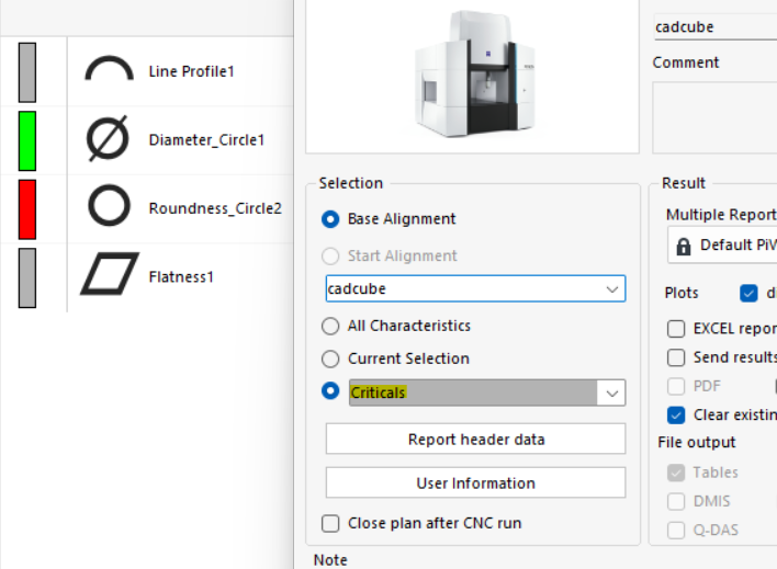

[Ch...] Posted June 11, 2025 Share Posted June 11, 2025 There are a few different methods to do this: 1. Highlight the characteristics or features you want to run in your list and in the run window choose "Current Selection" to run only what you have selected. If you set the Base Alignment dropdown to "Current Alignment" it will not even run the alignment at the start. 2. Define a Mini Plan of only the characteristics you desire. Plan > Mini Plan and then select it in the run window. CALYPSO: Making a Mini Plan 1 Link to comment Share on other sites More sharing options...
