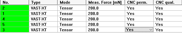

[Lu...] Posted June 11, 2025 Share Posted June 11, 2025 Hello, I am having some issues with my smallest size rubies occasionally breaking. I am starting to believe that the measuring force might be to blame, since just a moment ago i was doing a manual pickup on an internal circle, and watched it move slowly to the wall and snapped off right when it touched the side. It seems to happen on occasion for many of the operators where I work at and I cant really think of another cause that would explain everything I have been seeing. The diameter of the stem is 0.4 mm, with the ruby size being 0.5 mm, currently it is set to 200 [mN] (which I'm not sure what that exactly means) which I noticed is the same measuring force as all of my larger probes, which leads me to believe that it has never been changed (the one who set a lot of this up no longer works where I work) Any advice is very appreciated, and please let me know any extra info that would be helpful for me to add (I would link the exact probe, but I think that's illegal here lol) 1 Link to comment Share on other sites More sharing options...
[Ch...] Posted June 11, 2025 Share Posted June 11, 2025 recommend 100mN if shaft is more rigid and passes qual, otherwise 50mN 1 1 Link to comment Share on other sites More sharing options...
[Lu...] Posted June 11, 2025 Author Share Posted June 11, 2025 (edited) Please sign in to view this quote. thank you very much! where did you find this information so i can use it in the future? And I am having difficulty finding the location to change measurement force, i found it in the "characteristic settings editor" under resources. Is that the only location? i tried editing it in the stylus system editor, but it wouldnt let me click on it, i also dont see a way to change it in a calibration program i have since i read that the measurement force must be changed prior to calibration but i cant find it there either. I am not finding anything off of google on how to change that setting, thanks again! Actually nevermind i believe ive figured it out. I was trying to change my automatic callibration program thinking the setting was in there while i actually needed to do the callibration manually via the "probing system qualification" menu where it prompts me to imput a probing force for the qualification. I believe all of the automatic qualifications will be set to the correct force afterward. Thanks though! Edited June 11, 2025 1 Link to comment Share on other sites More sharing options...

[Lu...] Posted June 11, 2025 Author Share Posted June 11, 2025 Please sign in to view this quote. Thank you very much for the response! Looks like the probing dynamic was set to 100% which im thinking is the actual main cause (though i believe both were set too high) so now i have the probes set at 100 measuring force and 50% probing dynamic. Thank you all for your help! 1 Link to comment Share on other sites More sharing options...

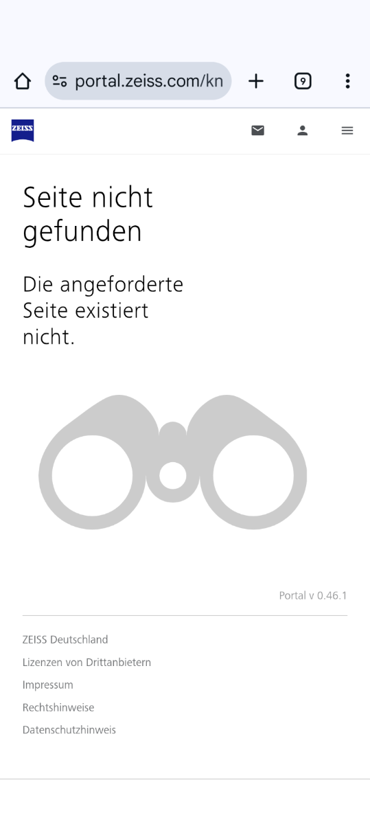

[Re...] Posted June 16, 2025 Share Posted June 16, 2025 Please sign in to view this quote. Hallo können sie die Seite überprüfen? Ich habe sie auf dem Handy und auf 3 Rechner ausprobiert und bekomme eine Fehlermeldung. Siehe Anhang. Danke Link to comment Share on other sites More sharing options...
[Ma...] Posted June 16, 2025 Share Posted June 16, 2025 Please sign in to view this username. Go to ZEISS portal -> Profile -> Change your Country to "United States of America" - this will allow you knowledgebase 1 Link to comment Share on other sites More sharing options...
[na...] Posted January 29 Share Posted January 29 Please sign in to view this quote. Please sign in to view this quote. After changing country to USA, logout and re-login seems to help. 1 Link to comment Share on other sites More sharing options...
