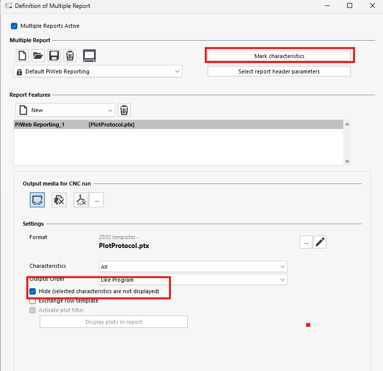

[To...] Posted June 13, 2025 Share Posted June 13, 2025 When I use Plot Protocol, I am not able to control which plots are included, regardless of settings in characteristics settings editor. Am I missing something? Calypso 7.6.20 1 Link to comment Share on other sites More sharing options...
[Ma...] Posted June 14, 2025 Share Posted June 14, 2025 I don't know if they changed anything, but i think there is no control within Calypso which plot you want to hide. Whenever i face some unwanted plots i make a specific template for a program with hidden / deleted plots. I still don't know why they are making things harder to set - aka mask/mark to hide characteristic. Link to comment Share on other sites More sharing options...
[Pe...] Posted June 25, 2025 Share Posted June 25, 2025 I am also looking for how hide plot protocols. One way is to change attribute of characteristic K2006 on No. (Hide on). But I need this key on Yes. Link to comment Share on other sites More sharing options...
[Pr...] Posted July 2, 2025 Share Posted July 2, 2025 Yeah, I am running into the same problem. It doesn't make any sense. Plots only show up on the "protocol" page if I go into the program and turn on "display plots in report". But when I use the "plots" page, it just automatically plots everything that it can. Link to comment Share on other sites More sharing options...
[An...] Posted August 6, 2025 Share Posted August 6, 2025 You can try using the mark and hide check box options. The hide check box is per PiWeb template so it won't hide your standrad report if you turn it on just for the plot protoocol. But the mark option is general so if you need to hide different things on seperate templates you will run into issues. Link to comment Share on other sites More sharing options...
[An...] Posted August 6, 2025 Share Posted August 6, 2025 Please sign in to view this quote. Characteristics settings editor will not work with the Plotprotocol. It only works with the standard protocol and the exchange row template option. Link to comment Share on other sites More sharing options...
