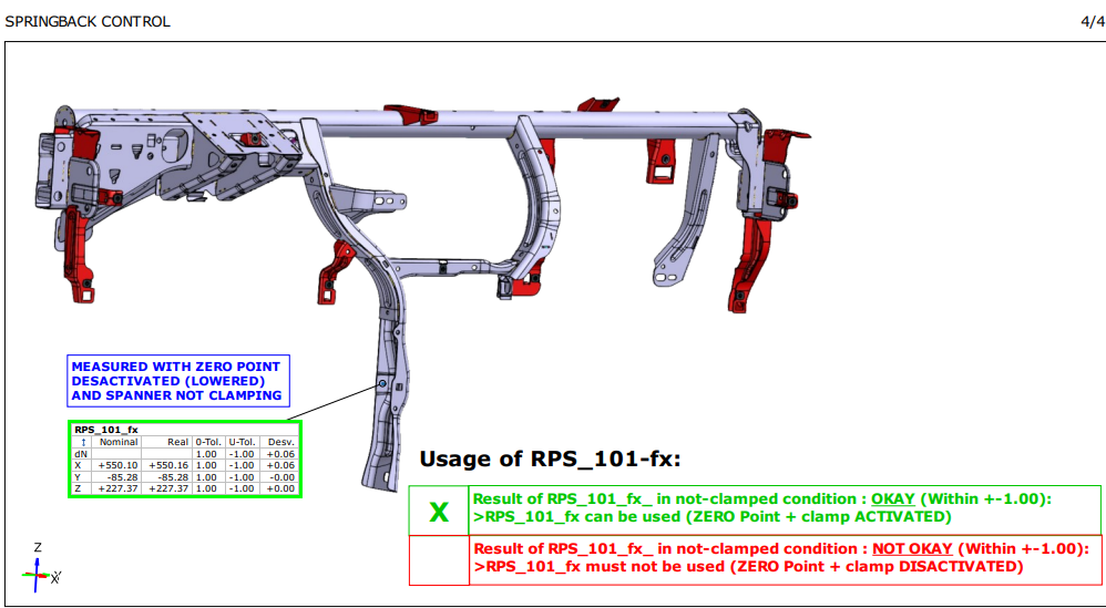

[Fr...] Posted June 16 Share Posted June 16 it is possible to have 2 meshes within the same program?, one with the clamped part and another mesh with the part without clamping and in the report select elements with respect to one mesh or the other. This is to avoid having to launch another program to measure only one surface point (Springback) and also so that in the DMO that I export to Piewb everything is included (the data of the complete measurement program + the surface point of Springback). Thank you Link to comment Share on other sites More sharing options...
[Na...] Posted Tuesday at 09:56 AM Share Posted Tuesday at 09:56 AM Hello Fran, you could import the second mesh as "new stage". Report pages can be selected all at once, copy and paste -> RMB -> reconfigure report page and display values for the second stage. Or set report pages to flipbook and every page will be expanded for every stage in the project. You can also compare/measure values from stage to stage for example. Exports will respect the active stage generally. And one final note: Maybe the virtual clamping option might be a solution for you. The virtually clamped mesh will be available as a mesh variant in the project and a practical fixture is not necessary. Nanno Link to comment Share on other sites More sharing options...
