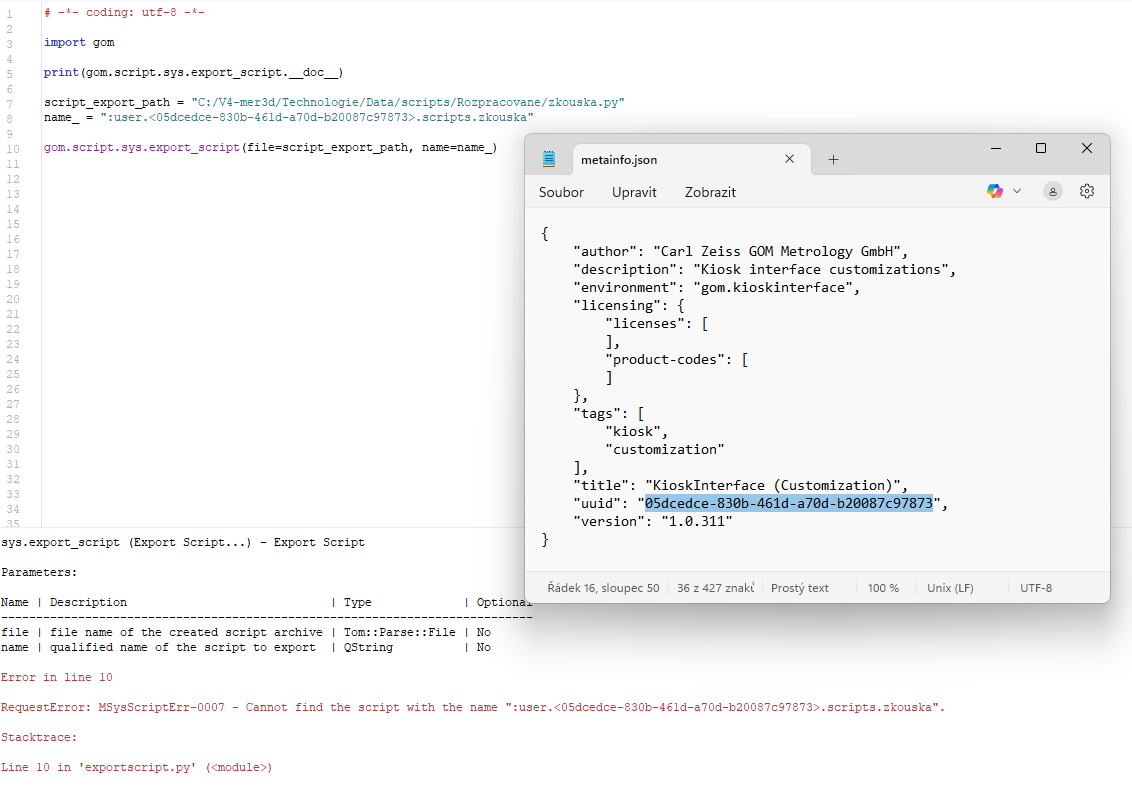

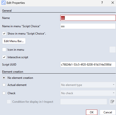

[Li...] Posted July 3 Author Share Posted July 3 Hi, script_export_path = "C:/V4-mer3d/Technologie/Data/scripts/Rozpracovane/sss.py" name = "81d6d575-9c08-4428-9526-8820faa1523d" I can't figure out the correct format for name. gom.script.sys.export_script(file=script_export_path, name=name) name = "c76824b1-53c5-4f20-8208-61b314e3590d" name = ":user.c76824b1-53c5-4f20-8208-61b314e3590d.scripts.sss" name = ":lsefranek.c76824b1-53c5-4f20-8208-61b314e3590d.scripts.sss" Cannod find the script with the name ...... Link to comment Share on other sites More sharing options...
[Ma...] Posted July 3 Share Posted July 3 Hi, the correct format is name = ":user.<app_uuid>.scripts.sss" with <app_uuid> from the element "uuid" in the file metainfo.json (not the script's UUID from the script properties. Best regards, Matthias Link to comment Share on other sites More sharing options...

[Ma...] Posted Thursday at 07:30 AM Share Posted Thursday at 07:30 AM Hi Please sign in to view this username. , the angular brackets in '<app_uuid>' were meant to indicate a placeholder, i.e. you have to omit them when using an actual app_uuid: name_ = ":user.05dcedce-830b-461d-a70d-b20087c97873.scripts.zkouska" Best regards, Matthias 1 Link to comment Share on other sites More sharing options...

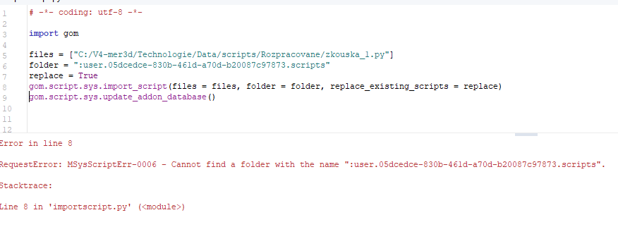

[Li...] Posted Friday at 08:59 AM Author Share Posted Friday at 08:59 AM Thanks, I tried that, it doesn't work Best regards, Libor Link to comment Share on other sites More sharing options...

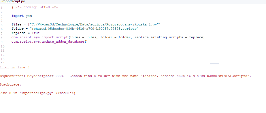

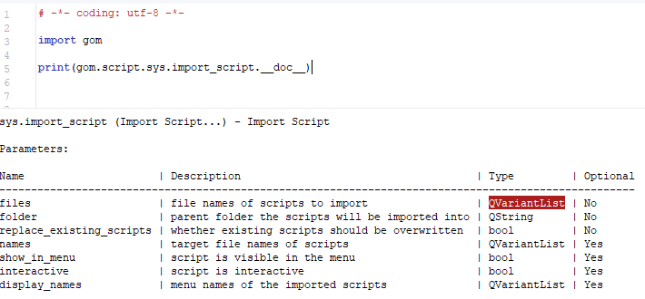

[Li...] Posted Friday at 09:02 AM Author Share Posted Friday at 09:02 AM I tried too gom.script.sys.import_script. but i don't know the format QVariantList Link to comment Share on other sites More sharing options...
