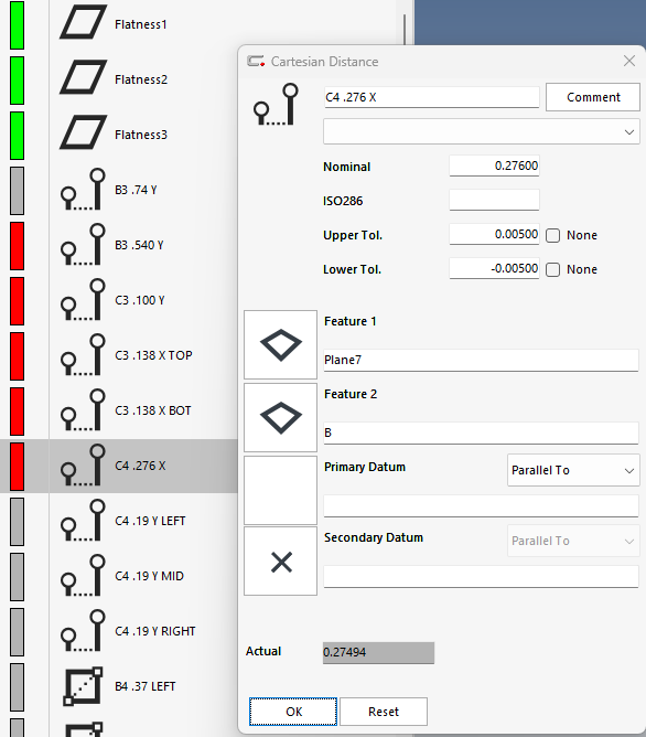

I recently updated to windows 11 and lost my configuration files, essentially having to start from the ground up. (luckily my part programs were backed up)
When I load in one of the old programs (same version of calypso 7.6.00) the "tolerancing method" block in the characteristic is blank, and even if the tolerance and the result is correct the characteristic still fails. I am hoping I missed something. See the image below:
Is it possible that you typed in these upper/lower tolerance values before clicking "OK" and the color behind just hasn't had a chance to update? Typically the red/green color indicator won't update until the window is closed.
It is a proven program that I have been running for over a year. This issue has impacted every program since updating.
When I re-type the actual tolerance it turns green and reads it properly. I am hoping to avoid having to do that on all of the characteristics on all of the programs that are on this machine.
Are you able to re-select the tolerance mode?  It appears that it is trying to hold you to an actual value between .005 and -.005, i.e. Max/Min
 Round-off presets: round-off measure .0001" , Mode: Automatic from nom. Geometry, Tolerance: Number scale
 Reselecting the tolerance mode works except that it will also change the actual tolerance. Once I re-type the tolerance it works. (but doing this on every program would be very tedious) I screen recorded a vid, I hope y'all can view it. Thanks guys.
