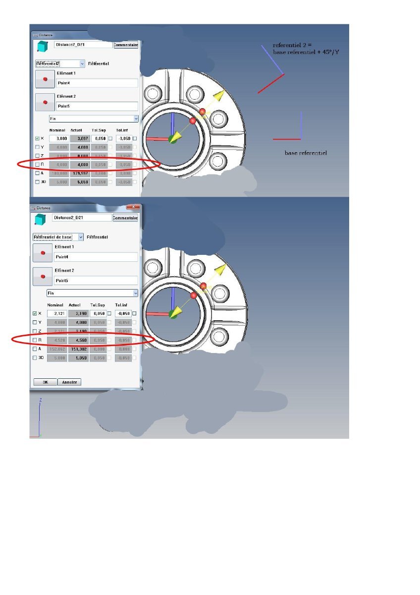

[ni...] Posted June 18, 2025 Share Posted June 18, 2025 Hi guys, not a big deal, but I don't anderstand what Radial distance (R) is ? in refentiel2 the radial distance is exactly equal to the distance along Y axis, but in base alignement not at all, but the two refentials have the same Y axis ! , (ref2 is a rotation of base alignement along Y axis.) and a secondary question, I have to use "space point" to have the good distance, with "contact point" the value are weird. What for "contact point" are ? thanks Nico Link to comment Share on other sites More sharing options...

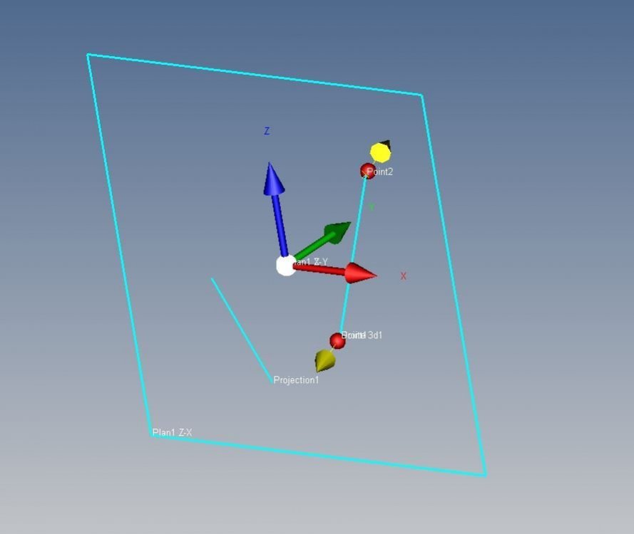

[Ma...] Posted June 18, 2025 Share Posted June 18, 2025 Hi, what i found is that R measurement is calculated from axis of Rotation in space ( primary ). So with R you won't see difference in heights, while 3D will calculate distance in all three axis. If you don't need this fancy stuff with MIN/MAX and meas. point/ feature then you can use polar distance - it will use feature's alignment. About space point - look into manual about calculating space/plane and other points. I am using plane points mostly - not sure why you need space points. Link to comment Share on other sites More sharing options...
[ni...] Posted June 18, 2025 Author Share Posted June 18, 2025 Hi Martin, you are right, plan point and space point give same results. contact points seems to correct the vector by the axes and in this case I am at 45° calyspo return doomy results. when I defin a point it is by default in "contact point" is it a way to define plan point by default ? the work is done, I have my result with 3 method, : distance along axis in a rotationned referentiel, polar distance and texte result with :getActual("Point5").coordPolRadius- getActual("Point4").coordPolRadius, for the last "reference for coordinate cylindrical" in the element windows has to be set to Y still don't figure how "R" work. I have effectively the distance by the primary in the first case (referentiel2) , but not with base referentiel, wich have the same primary ! Link to comment Share on other sites More sharing options...
[Ma...] Posted June 18, 2025 Share Posted June 18, 2025 You can define default evaluation for a point, but only from features menu. Using mouse to take points on model will select space point. "R" work like this - it will project measured points on primary plane, calculate difference in X and Y ( or any relevant axis ) and use trigonometry to obtain the longest line of triangle - Pythagoras - R = √(delta_x2 + delta_y2) https://www.calculator.net/pythagorean-theorem-calculator.html Link to comment Share on other sites More sharing options...

[Ma...] Posted June 18, 2025 Share Posted June 18, 2025 R is basically the hypotenuse of the triangle based on the alignment. This is projected on the working plane and is not the 3d measurement. Link to comment Share on other sites More sharing options...
[ni...] Posted June 23, 2025 Author Share Posted June 23, 2025 Finaly I got it, R equal to length of projection in Z/X (or in Z/Y if length (projection ZY) smaller than length (projection ZX) Link to comment Share on other sites More sharing options...
