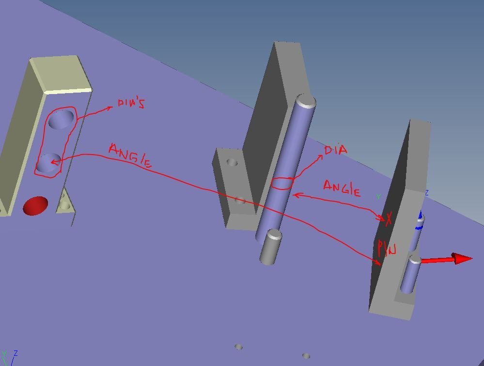

[AG...] Posted June 19, 2025 Share Posted June 19, 2025 Hello all, i am having brain fog. Wanted to ask for a quick how to get the angle dimension from the plane highlighted to the diameters highlighted. I am drawing a blank? Thanks for the help much appreciated. Link to comment Share on other sites More sharing options...
[AG...] Posted June 19, 2025 Author Share Posted June 19, 2025 The short angle is 6 degrees and the angle between the post and the 2 diameters highlighted on the tower are supposed to be 15 degrees. Link to comment Share on other sites More sharing options...
[na...] Posted June 20, 2025 Share Posted June 20, 2025 Please sign in to view this quote. Check in Calypso how it's done, I would guess that there is some kind of center defined, otherwise the angle is 180° Assuming Calypso based on screenshot. Link to comment Share on other sites More sharing options...
