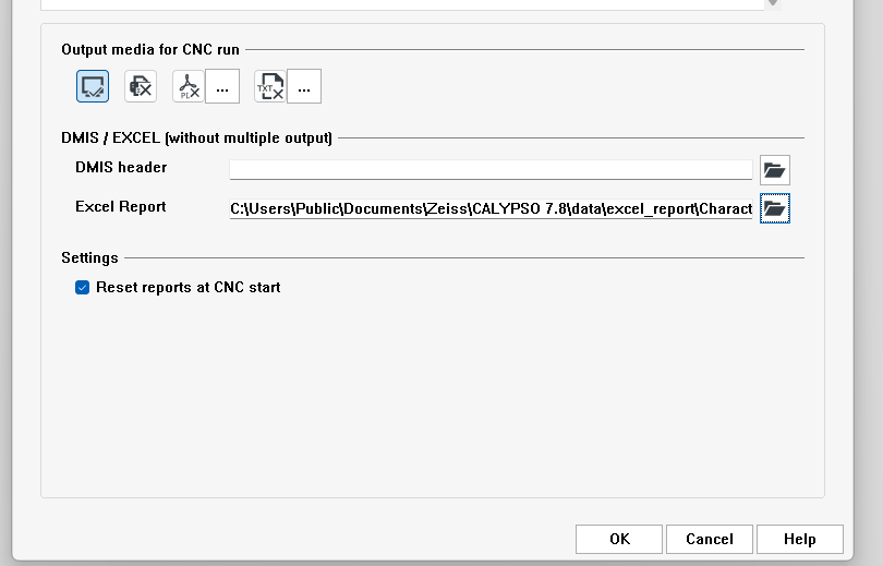

[Ni...] Posted June 20, 2025 Share Posted June 20, 2025 Anyone using 1-Factory? Curious about your thoughts on it? It appears to be a useful tool, but it will require significant adjustments to our existing naming convention, which is currently used across all, you know, hundreds of CMM programs. A few extra scripts have been required to get the reports to upload to the 1Factory software successfully. I feel like I may be missing something within Calypso that could solve that issue. The IT department keeps telling us that Windows has been trying to make Macros a thing of the past. Using the "Excel Report" output below (believed to be required for 1-factory) is very macro-heavy. Does anyone have any experience with outputting measurement results from Calypso to 1Factory? Link to comment Share on other sites More sharing options...

[Ni...] Posted June 30, 2025 Author Share Posted June 30, 2025 Please sign in to view this username. this link should help you get started with the auto-upload to the CMM. 2. Auto Upload CMM Files (Automated File Upload) – 1factory, Inc. What we have found is that we needed to add to the 1factory script: first to close the Excel report template that Calypso opens when the measurement is complete, then move that Excel report from the results file to the "in" folder (created for 1 factory). We also had to add a formula to the "Characteristics.xlt" file to rename the measurement plan field to add the inspection type to the measurement plan name (required for 1 factory). We currently have it functioning; however, with my limited experience in adjusting report header variables and Excel outputs, it took a lot of trial and error. Particularly with using the characteristics.xlt output and the ReportINI.xlt file. Then throw into the mix the Windows permissions that the IT department sets, and it was all hands-on deck to get the PowerShell scripts to function. 1 Link to comment Share on other sites More sharing options...
