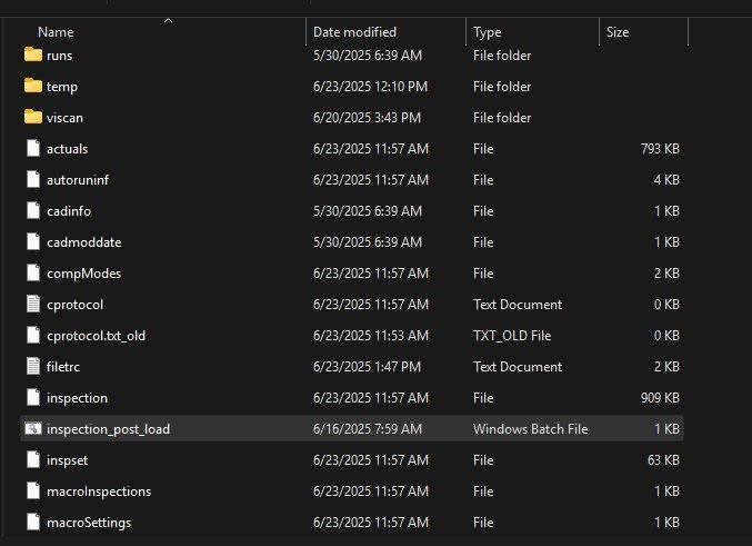

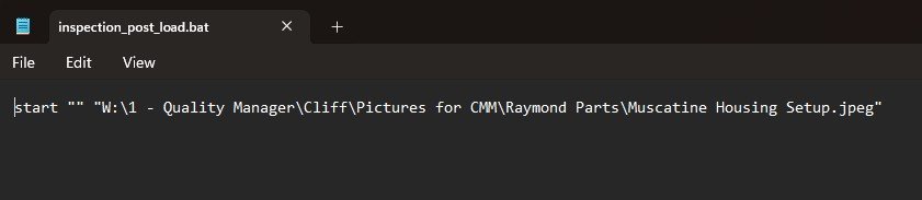

[Cl...] Posted June 23, 2025 Share Posted June 23, 2025 Where are you saving the picture? If you are saving it inside the program folder it might that the file address is no longer valid you could try making a dedicated fold of pictures. Alternatively, you could use a BAT file to make a picture popup when you open a program. A super simple one I use all the time is start "" "file address\picture.jpeg". If you save that as inspection_post_load.bat and drop that in the program folder that will open a photo first thing when the program is opened. 2 Link to comment Share on other sites More sharing options...
