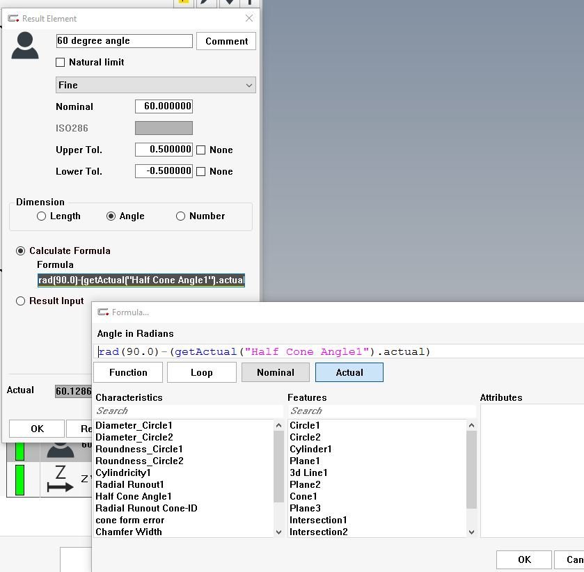

[D...] Posted June 24, 2025 Share Posted June 24, 2025 I need to display 1\2 the cone angle, but from the face of the part, NOT from centerline. So, a results element would do the trick, right/ But the output is in radians. I don't have PCM but I'm sure I can convert to degrees with a PCM command in the formula. I don't recall the command. Any help here would be great! Link to comment Share on other sites More sharing options...
[Ma...] Posted June 24, 2025 Share Posted June 24, 2025 Multiply the value by 57.29577 and it will convert to degrees 1 Link to comment Share on other sites More sharing options...
[Ri...] Posted June 24, 2025 Share Posted June 24, 2025 In the formula, just put a rad() around the get.Actual and that will convert it for you. 1 Link to comment Share on other sites More sharing options...
[To...] Posted June 24, 2025 Share Posted June 24, 2025 rad(90-getActual("Cone_6 Dia").apexAngleHalf) 1 Link to comment Share on other sites More sharing options...
[Da...] Posted July 1, 2025 Share Posted July 1, 2025 This is what worked, Once set to angle , everrything fell in to place. Thanks Guys!!😃 2 Link to comment Share on other sites More sharing options...
[To...] Posted July 7, 2025 Share Posted July 7, 2025 Please sign in to view this username. Sorry about that. from a minimalist's point of view, this also works. rad(90)-getActual("Cone1").apexAngleHalf 1 Link to comment Share on other sites More sharing options...
