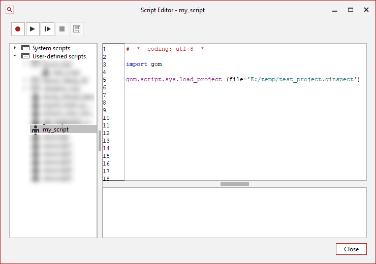

[Má...] Posted May 31, 2021 Share Posted May 31, 2021 Hello All, I would like to start the program and one of the script by using external python script. I could open the software with the following: ----------- filepath = 'C:/Program Files/GOM/2020/bin/gom_inspect.exe' import os os.startfile(filepath) ----------- Could you give advice about starting a script with external python? BR, Máté Link to comment https://qualityforum.zeiss.com/topic/238-start-the-gom-software-and-a-script-using-python/ Share on other sites More sharing options...
[Th...] Posted June 3, 2021 Share Posted June 3, 2021 There is an "-eval" command line parameter which can be used to run scripts in GOM Software by importing them. Lets's assume you have such a script called my_script in GOM Software: Than you can run it by command line parameter from another script this way: import subprocess subprocess.call ('"C:/Program Files/GOM/2020/bin/gom_inspect.exe" -eval "import my_script"') Link to comment https://qualityforum.zeiss.com/topic/238-start-the-gom-software-and-a-script-using-python/#findComment-704 Share on other sites More sharing options...

[Má...] Posted September 30, 2025 Author Share Posted September 30, 2025 Hello, How is it look like in SW 2023? Start of the program is ok, but how can I start a script inside our program? Best regards, Máté Link to comment https://qualityforum.zeiss.com/topic/238-start-the-gom-software-and-a-script-using-python/#findComment-139205 Share on other sites More sharing options...
[Ma...] Posted October 10, 2025 Share Posted October 10, 2025 Hi, you can find the information here: Software and script starting options — App Development Documentation Best regards, Matthias 1 Link to comment https://qualityforum.zeiss.com/topic/238-start-the-gom-software-and-a-script-using-python/#findComment-139915 Share on other sites More sharing options...
