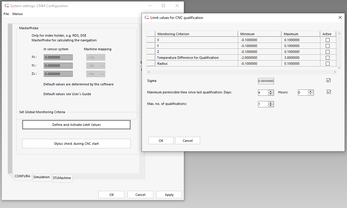

[Ow...] Posted July 9, 2025 Share Posted July 9, 2025 As defined above, every work scenario is different. We have a lot of Duramax CMM's that I set the global stylus limit values to require a qualification of all probes every 24 hours, with a sigma value of 0.002mm max. The protocol requires that all styli be cleaned before running the qualification program. I do this because on some of them, several different operators use the CMM (set to run in the autorun interface) on different shifts and there is no way to absolutely ensure every part is clean before every part is run and dirt/debri/sticky-stuff can accumulate on the probe that can not be seen with the naked eye and will affect results. I have a daily (every 24 hours) qualification program set to qualify as passive (doesn't take long) and a once a week (generally Monday) that qualifies with the geometry qualification, which takes about 25 minutes. In the limit values, you can set how many hours elapse before the CMM won't run without the styli being qualified. 2 Link to comment Share on other sites More sharing options...

[Tr...] Posted July 9, 2025 Share Posted July 9, 2025 Please sign in to view this quote. Where do you turn this on at inside of Calypso? I thought I had it turned on and tried lessening the timeframe to where I know they haven't been done since, but it still allowed for the part program to run. Thanks in advance. I'd like to turn it on to where it has to happen within 4 days of the last one. I thought it was here, but I am assuming I need to click the activate on the monitoring criterion? Link to comment Share on other sites More sharing options...

[Tr...] Posted July 10, 2025 Share Posted July 10, 2025 Please sign in to view this username. Recently we put into effect across 8 CMM's we use that 1 time a week is no longer sufficient, and we now require minimally 2x a week. Recommended to do daily. The CMM in my specific lab I'm keeping a 3x a week(Mon, Wed, Fri) consistently since we are saving probe qualification sigma value's reports. But to ensure a consistency want to test putting a limit in the system on it to require it to be done. Hopefully Please sign in to view this username. can provide me what I'm missing to making this efficient from my quoted post above. Link to comment Share on other sites More sharing options...
[Ow...] Posted July 10, 2025 Share Posted July 10, 2025 Please sign in to view this quote. Travis, Sorry, I rarely get time to get on here and answer questions anymore, just opinions:-). I have it set-up just like you do, except @ 23 hours (0 in days) with both the sigma and Maximum permissible time check-marked as active. Most of our Duramax's are running version 6.0 to 6.2 and according the operators that get here way before I do, it works. Link to comment Share on other sites More sharing options...

[Ow...] Posted August 12, 2025 Share Posted August 12, 2025 Please sign in to view this quote. For the record, last week I was able to verify that this qualify every 23 hour mandate does and is working as I defined above. If not qualified in that time frame, the CMM pops up a window that basically says the probe needs qualified. Link to comment Share on other sites More sharing options...
