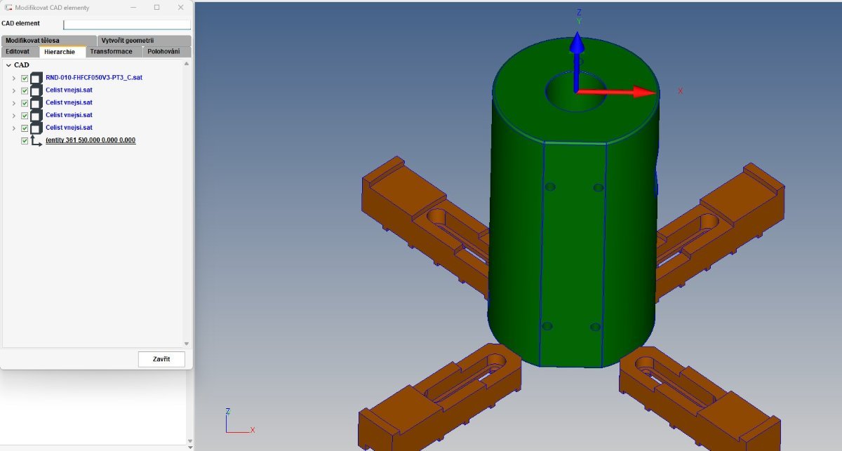

[Da...] Posted July 9, 2025 Share Posted July 9, 2025 Hello everyone, I have a problem with deleting a CAD model in the program. First method: I delete the model in the program hierarchy, close the program, save it and open it, but the model is still active. Second method: In CAD-VIEW-DELETE, I delete the model and close the program, save it and open it, but the model is still active. Third method: Modify CAD elements-Modify bodies-Edit-Delete body, delete the model and close the program, save it and open it, but the model is still active. If I have more models, there will always be one that cannot be deleted. The only method to delete a CAD model is to delete the files directly in the program folder, which is very clumsy. Another problem concerns merging models. If I create a program and insert multiple models, they merge into one when I save and close the program and they can no longer be manipulated and behave as one whole. Only one CAD model is visible in the hierarchy. Not a single thing makes sense to me why this is so? It worked in the previous version of CALYPS. Thanks a lot for the insights and ideas Calypso 7.8.1201 (12.03.2025) 2 Link to comment Share on other sites More sharing options...

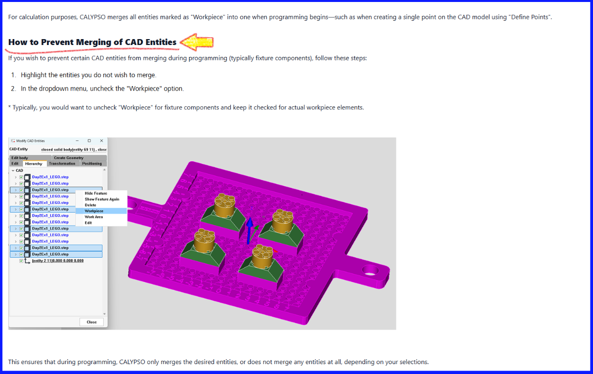

[Ch...] Posted July 9, 2025 Share Posted July 9, 2025 Regarding the 2nd issue of merging CAD models reference - CALYPSO: Merged CAD Entities For the deleting CAD issue is this only one program that won't delete the model? Or all programs on your system? 2 1 Link to comment Share on other sites More sharing options...

[Da...] Posted July 10, 2025 Author Share Posted July 10, 2025 (edited) Please sign in to view this quote. It is in all programs where a CAD model has been inserted or has already been inserted. This happens in the new Calypso 7.8, in the previous version it was possible to delete models, now one always remains there. Regarding the merging of models, these are separate models (not Entity models), which merge themselves only after the program is saved and closed, after that the models cannot be manipulated separately, e.g. color, etc. I also noticed that you have *.step files, we have *.sat files. So if this is not the problem? One more thing, merging models into one always happens when a strategy is edited or a new one is created, if the old program is opened and the strategy is not edited, the models will remain separate. Tested on a few programs today. There is an error in the link :(. Edited July 10, 2025 Link to comment Share on other sites More sharing options...

[Ch...] Posted July 15, 2025 Share Posted July 15, 2025 Please sign in to view this username. Glad you found it helpful! I couldn't agree more, so many little things buried within the software and the forums are a great place to bring them to light. 😀 Please sign in to view this username. The steps in CALYPSO: Merged CAD Entities should prevent the merging of CAD in my experience. However I see the same as you when trying to delete a model in CALYPSO 7.8 & 8.0. I will escalate this to the CALYPSO Dev Team in hopes for a cleaner resolution in a future Service Pack update. 1 1 Link to comment Share on other sites More sharing options...
