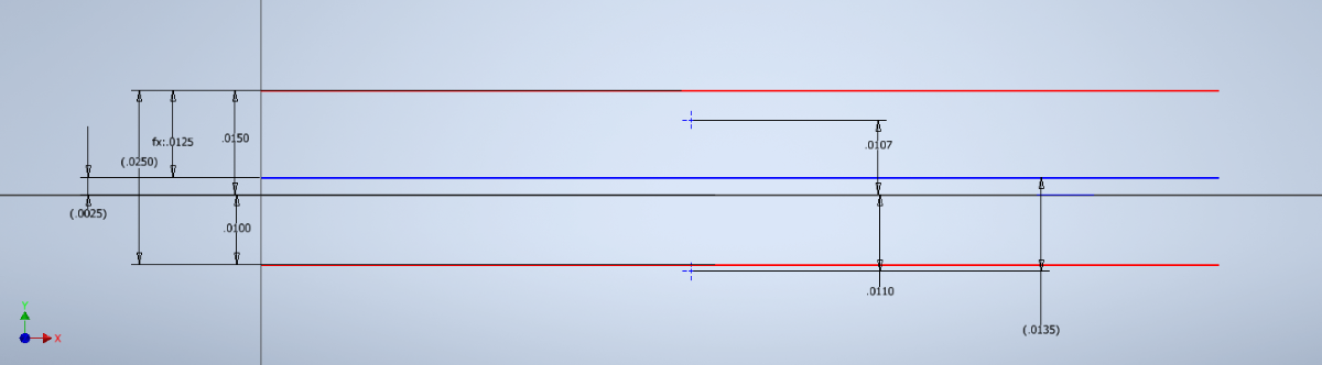

[Jo...] Posted July 10, 2025 Share Posted July 10, 2025 Hello All, I hope that someone can help me understand a result. I am measuring a line profile with a curve. The callout is .025" with an unequally dispose tolerance of .015 to the add mat'l side. (.025 U .015 -AB-) -AB- is fully constrained. I'm trying to understand how calypso calculates this. This is the result for the characteristic along with the min and max points: I've been looking for how an unequally toleranced profile is supposed to be reported but have only found how to define the tolerance zones. What I think should happen would be to take the absolute value of the deviation from the side that uses the most of its tolerance, add the absolute value of the tolerance from the opposite side, and report that number. For example, for the characteristic above, the minus side is .0010" over the tolerance for that side at .0110". If you take that number and add the .0150" tolerance from the plus side, the reported number would be .0260". Why is Calypso reporting the number at .0269"? 1 Link to comment Share on other sites More sharing options...

[Ri...] Posted July 10, 2025 Share Posted July 10, 2025 (edited) You will need to reference Y14.5.1 if you want to understand the math. Calypso does this though: If it is Bilateral with equal tolerance direction, the Profile result is always whatever the largest deviation is X 2. If it is Bilateral with unequal tolerance direction, the first thing Calypso does is find the tolerance nominal: In your specific case, the tolerance nominal is +0.0025 above the true profile nominal Now calculate what is the largest deviation from the tolerance nominal In your specific case, the largest deviation is the 0.0110 deviation from the true profile nominal, which is actually 0.0135 from the tolerance nominal Now multiply the largest deviation from the tolerance nominal X 2 to get your Profile result In your specific case 0.0135 X 2 is 0.027 (I suspect rounding is why the result doesn't match 1:1) Now, which one do you report to your customer, well it depends on the customer. Lol. A lot of customers would just want the Profile result, but a lot of my Aerospace customers would want both results (Profile result, as well as the Min/Max values). Here is a sketch. The black line is the true profile nominal, the red lines are the tolerance bands, and the blue line is the tolerance nominal. I hope this helps. Edited July 10, 2025 1 Link to comment Share on other sites More sharing options...

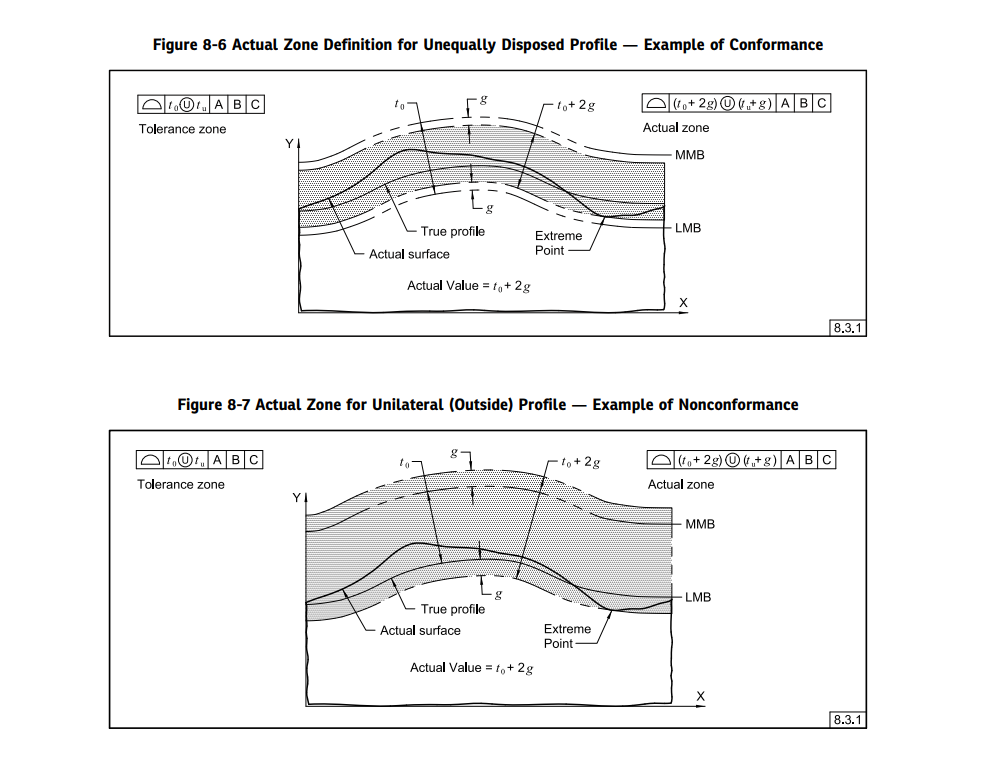

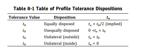

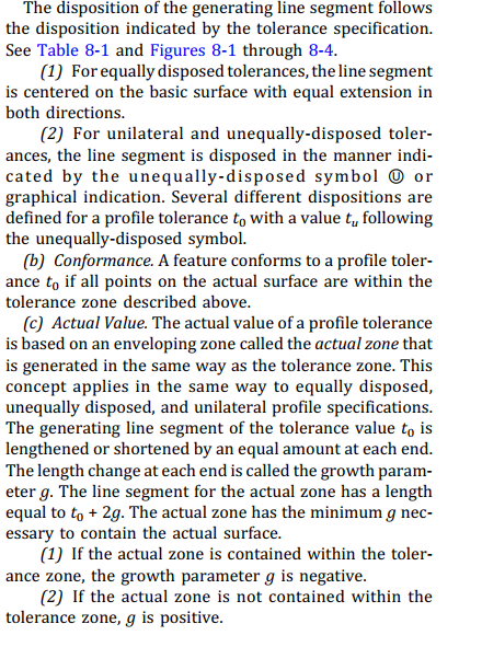

[Ri...] Posted July 10, 2025 Share Posted July 10, 2025 (edited) I cannot speak for the ISO standard because I don't have access to it, and honestly the ISO standard is a mess compared to the ASME standard. Either way - per ASME 14.5.1-2019 the math is the following: The actual value is t0 + 2g Where t0 is the tolerance value Where g is growth parameter, or essentially the distance of the actual profile to the tolerance band (this g is to be calculated from both sides of the tolerance - essentially your min/max values) If the actual profile lies within the tolerance zone, the growth parameter (g) is negative. If the actual profile lies outside the tolerance zone, the growth parameter (g) is positive. So if your specific example, the Max deviation has a growth parameter of -0.0043, and the Min deviation has a growth parameter of +0.0010. t0 = 0.025 largest G is +0.0010 0.025+(2*0.0010) 0.025+0.0020 Actual value = 0.027 So is Calypso doing that? Essentially, but just in a different way. I think Calypso just takes the approach that it is easier to understand that the Profile result is always whatever the largest deviation from nominal * 2 is - the only thing to remember is that if it is a bilateral tolerance with equal distribution the nominal is the true profile, and for a bilateral tolerance with unequal distribution it is the tolerance nominal. Edited July 10, 2025 2 Link to comment Share on other sites More sharing options...

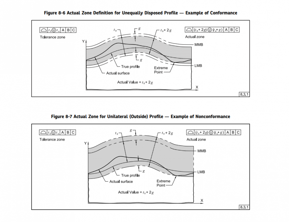

[To...] Posted July 14, 2025 Share Posted July 14, 2025 Here's something I found that might be interesting to some. Link to comment Share on other sites More sharing options...
