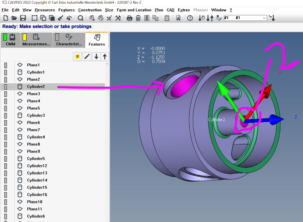

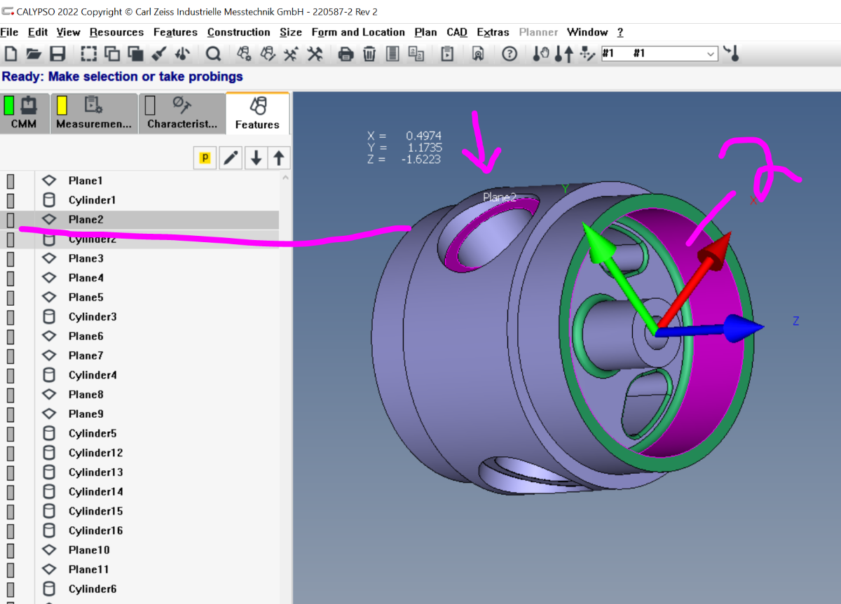

[Ra...] Posted July 11, 2025 Share Posted July 11, 2025 Hello, I need help resolving an issue I'm experiencing with the Calypso 2022. When I select one object, two objects are selected simultaneously. This is causing problems because when I try to assign specific measurements to each object, the system doesn't respond correctly. It seems to treat both objects as if they are already selected, even though I only intend to work with one. It appears that the objects might be stuck together or overlapping. I’ve already tried using the "Healer" tool, but it didn’t resolve the issue. How can I separate these objects so that the system recognizes and selects them individually? See images below Thank you, Link to comment Share on other sites More sharing options...
[Cl...] Posted July 11, 2025 Share Posted July 11, 2025 I'd try healing the model to start with. 1 Link to comment Share on other sites More sharing options...
[Ke...] Posted July 11, 2025 Share Posted July 11, 2025 This is where I would just create the individual features by selecting portions of the wire frame 1 Link to comment Share on other sites More sharing options...
[Ra...] Posted July 11, 2025 Author Share Posted July 11, 2025 Creating an individual features, I was able to fix this problem. Thank you, 🙂 Link to comment Share on other sites More sharing options...
