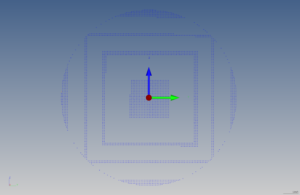

[Iv...] Posted July 17, 2025 Share Posted July 17, 2025 Hi, I want to extract/recall circle paths from a high volume of cylinders that have already been created and inspected. Due to the volume, I would like to automate the process. Scope: The measurement plan contains a high volume of Cylinders (2000+). Each cylinder is commonly named Cylinder1, Cylinder2, etc. Each Cylinder contains the same strategy (5 circle paths) and evaluation. The pattern of the hole set is not consistent, meaning there is no consistent X and Y offset. Goal: Use an automated process to recall the feature points of each circle path within the Cylinder. I.e., Cylinder1 → Circle1_1, Circle1_3, Circle1_5, where the underscore index represents the circle path. I have coding experience but no direct PCM experience, so I was hoping to avoid PCM. But I'm happy to give it a shot. Any help would be appreciated. 1 Link to comment Share on other sites More sharing options...

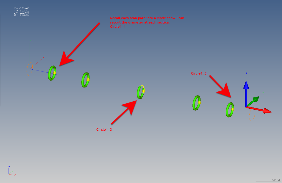

[Iv...] Posted July 17, 2025 Author Share Posted July 17, 2025 Thanks for the response. Let me add some extra information. I would like to recall each scan path for each cylinder into a circle. Then, I would like to report the diameter size for each of these circular paths. Because there are over 2000 cylinders, I would like to avoid any manual process, such as your suggestion above. 1 Link to comment Share on other sites More sharing options...
[Cl...] Posted July 17, 2025 Share Posted July 17, 2025 You state: "The pattern of the hole set is not consistent, meaning there is no consistent X and Y offset". Do you have a model? 1 Link to comment Share on other sites More sharing options...
[Iv...] Posted July 17, 2025 Author Share Posted July 17, 2025 I do have a model, but I would be unable to upload it due. A screenshot of the pattern is below. Each hole shown represents a cylinder that was captured. Link to comment Share on other sites More sharing options...

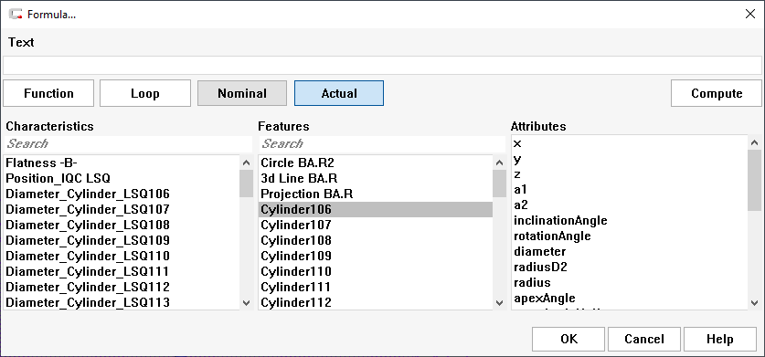

[No...] Posted July 18, 2025 Share Posted July 18, 2025 (edited) I have to thank you for this topic! I've been working with Calypso for 18 years now, and only today found out that the feature(s) to be used in a point recall can also be parametrized with a formula (not just the point range). 😵🤯 But shame on uncle Carl, for the odd way in which this was implemented! Edited July 18, 2025 1 1 Link to comment Share on other sites More sharing options...
[No...] Posted July 18, 2025 Share Posted July 18, 2025 (edited) Update: While playing around with my new knowledge I found out that while you can put a formula on the point recall and specify the features to use with list("Feature1", "Feature2",...) there seems to be no syntax that would allow to further specify which scanning path(s) to take from those features. Adding a point range from the context menu when a formula is already present, doesn't seem to work (it doesn't get stored permanently), so if it's at all possible to define an additional range, it would have to be part of the formula itself. Does anybody know if and how this can be achieved with the list() function? Edited July 18, 2025 1 Link to comment Share on other sites More sharing options...
[Ow...] Posted July 18, 2025 Share Posted July 18, 2025 (edited) That's a lot of cylinders. Not the answer you're looking for, but for refence if you don't use it, anytime I want to use one feature to report the diameter and locations of the cylinder at different depths and cylindricity of all, I create individual circle features/strategies for each depth the cylinder is being measured at, group them together and then recall the circles into a stepped-cylinder feature. The stepped cylinder allows you to report all the diameter sizes and locations in one group. I wish they could add the form/roundness to the stepped cylinder as well, but that has been brought up in Zeiss's "my voice" suggestions a few times, to no avail. It may be easier to extract what you're looking for in a stepped cylinder, with filters applied, with PCM? Edited July 18, 2025 1 1 Link to comment Share on other sites More sharing options...

[Iv...] Posted July 18, 2025 Author Share Posted July 18, 2025 @Owen Long Very interesting! I never considered a Stepped Cylinder, and that could be very helpful in the future. But the major issue I foresee is that instead of 2000+ cylinders, I would have 10000+ circles (2000 holes x 5 circle paths per hole). And I would need to be very specific with the naming convention so that I could use PCM to recall the 5 circle paths into the proper cylinder. I think you may be alluding to this with your final comment. 2 Link to comment Share on other sites More sharing options...

[He...] Posted July 25, 2025 Share Posted July 25, 2025 Would this work for you? Short explaination: Cylinder1-Cylinder11: My try to mimic your current program. CylinderX(11): Recalling each cylinder individually in a pattern Circle_1(11) - Circle_5(11) - Recall the individual paths from the cylinder into 5 separate circles. Testplate.zip 1 Link to comment Share on other sites More sharing options...

[He...] Posted July 26, 2025 Share Posted July 26, 2025 Please sign in to view this quote. No PCM at all. The pattern is for collection all the individual cylinders in a single cylinder with a pattern to make it easier to work with. This is done with formulas in all the characteristics fields with getNominal() to mimic the values from the individual cylinders and with a formula in the recall feature points window. In Calypso 6.8 which I use it is a bit tricky to find the formula dialog. I don't know if they have fixed this in later versions but if you are having problems finding it, just tell me and I will describe it to you. From the cylinder with a pattern I can recall the individual measurement paths (in the recall feature points window, right click on the cylinder and click Open) into the 5 circles with a pattern and then I can evaluate whatever I want with them. In the characteristics list I removed the loop from the individual diameters and put the loop on the group instead. This doesn't really change anything other than you get all the different evaluations of a single cylinder grouped together in the printout instead of all sections 1 and then all sections 2 and so on. 1 Link to comment Share on other sites More sharing options...
[Ra...] Posted July 28, 2025 Share Posted July 28, 2025 Appreciate the response. It's really clever. When I tried reverse engineering it and making my own version, I got stuck at exactly where you mentioned, the recall feature points window with formula. I cannot for the life of me find anywhere to input or even view any formula in the recall feature points window. I've never seen the list "yellow", and it's actually why I thought there was PCM involved lol. Would you mind describing where to view that at? I'm also on 6.8. Link to comment Share on other sites More sharing options...
[He...] Posted July 28, 2025 Share Posted July 28, 2025 (edited) Please sign in to view this quote. The trick is to right click in an area not occupied by a feature name. The problem is that the feature names expands all the way from left to right and nowadays the vertical height of the feature names perfectly covers the vertical expansion of the window itself. In previous versions it was possible to right click on a small area below the last name in the list but not anymore. First you need to empty the list. The easiest way is to write something in the filter field (the white field below "Elements") that will get no hits. Just type ASDF in the field and the list empties. Then you can right click in an empty place to get access to the formula dialog. Edited July 28, 2025 3 Link to comment Share on other sites More sharing options...
