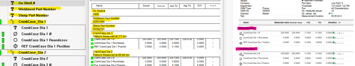

[Jo...] Posted July 21, 2025 Share Posted July 21, 2025 Hey All, I've noticed that when using PiWeb, comments are no longer being added to the report, and it also seems that it's not possible to insert a text element to serve this purpose. I'm trying to understand if there’s a way to include text elements or comments in the report, similar to how they appear in a custom report. Does anyone know how to turn this function on in PiWeb? I've attached an example for reference. Side by side are the characteristic list, a custom report, and the PiWeb report. TIA! Link to comment Share on other sites More sharing options...
[An...] Posted July 21, 2025 Share Posted July 21, 2025 Hi Joseph, I do not remember offhand which of CALYPSO removed the sending of Text Elements, but I believe that 7.2 re-introduced it. Ensure that the Upload Text Elements checkbox is selected under Resources-> Results to File -> PiWeb Reporting configuration. There is an article on the Knowledge Base, but I cannot load it for some reason at the moment. I can add it later as a separate comment if needed. 1 Link to comment Share on other sites More sharing options...
[Jo...] Posted July 22, 2025 Author Share Posted July 22, 2025 Perfect! Just what I was looking for! Thanks for the reply Please sign in to view this username. ! Link to comment Share on other sites More sharing options...
