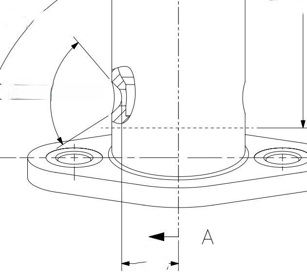

[Ro...] Posted July 22, 2025 Share Posted July 22, 2025 I am having a hard time figuring out how to check something and am hoping someone can lead me in the correct direction. I have a part that had a chamfer called out on the OD of the part with a depth from the centerline of the part to the intersection of the chamfer and the through hole. I cannot get the chamfer to check correctly. Calypso will not let me choose it as a cone. I tried using lines on the cone angles and the angle of the cone was way off, and the intersections were way off. I know I am overlooking something, probably very easy, but I cannot get this to work. Thank you for the help. I am attaching a photo of what I am talking about. Link to comment Share on other sites More sharing options...
[Ma...] Posted July 23, 2025 Share Posted July 23, 2025 Measure the circle as a cylinder, you need the axis line. Measure the “cone” with 2 lines as shown for the angle callout. You can create these line by sectioning the feature on the model. Now, intersect a line with the cylinder and click on shell. This will give you the cylinder edge. 1 Link to comment Share on other sites More sharing options...
[Ro...] Posted July 23, 2025 Author Share Posted July 23, 2025 Please sign in to view this quote. That worked. I knew it was something simple. My brain just was not functioning with this last night. Link to comment Share on other sites More sharing options...
