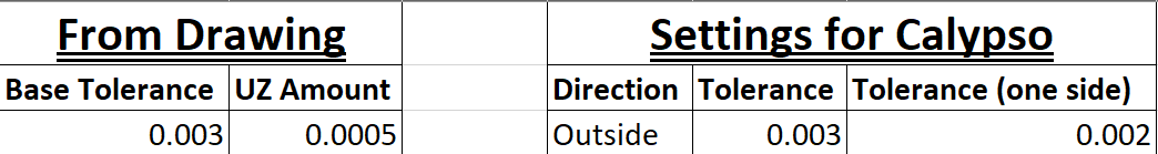

[To...] Posted July 23, 2025 Share Posted July 23, 2025 If a surface has a .003" profile tolerance after .0005" of plating, could use profile with an unequal distribution to compensate for plating and what would it look like in Calypso? Link to comment Share on other sites More sharing options...
[Ri...] Posted July 23, 2025 Share Posted July 23, 2025 (edited) I think it would be safer to just offset the nominal profile. If you are using Calypso 2025, you could use ISO evaluation and utilize the UZ to where you enter the offset. But if you prefer the legacy way. It would be a tolerance of 0.003 with a tolerance (one side) of 0.002 (leave it on the default of outside). Edited July 23, 2025 1 Link to comment Share on other sites More sharing options...
