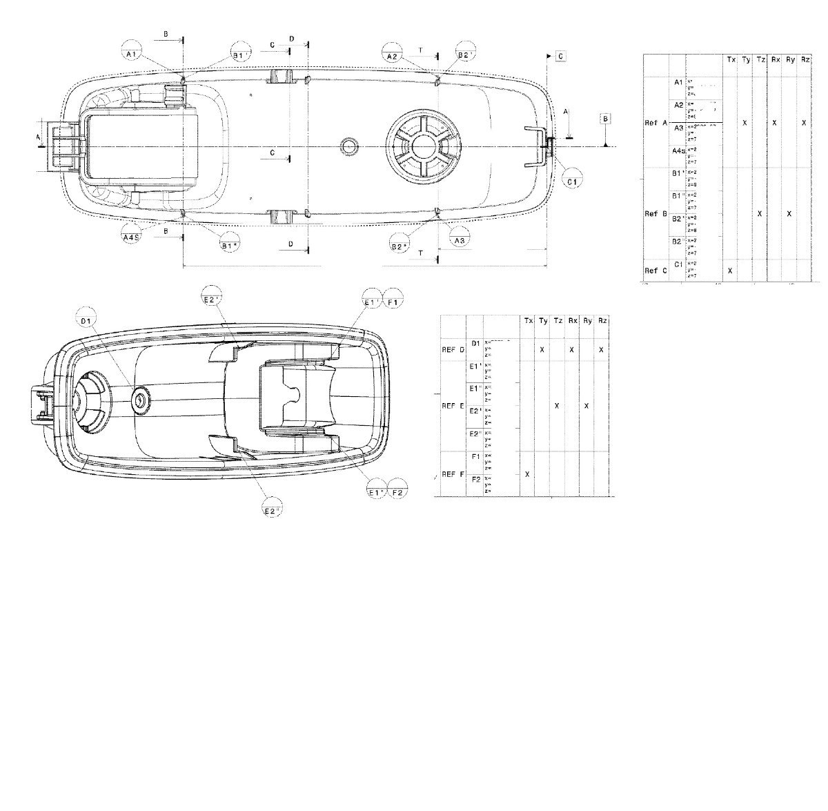

[Pe...] Posted July 25, 2025 Share Posted July 25, 2025 Hello everbody, please be kind to help me a bit. What kind of coordinate system is it on this drawing? Is it an RPS or not or what is it? In my opinion Ref A is a plane (A1-A4) , Ref B is a midline (B1', B1"-B2',B2"), and C is only a zeropoint. This would be a normal coordinate 3-2-1 system. But why does the drawing contain in the table a lot of XYZ coordinates for the points far away in the air ? Do I need them for creating the coordinate system ? And what is it about the ref D. it only a hole centerpoint? how to make a plane element out of it? how to align the part in the zeiss inspect software if the ref D is only a point? I would be happy that if you could help me and contact me via e-mail not only here in the forum. Thank you! Link to comment Share on other sites More sharing options...
[DW...] Posted July 29, 2025 Share Posted July 29, 2025 Please sign in to view this username. Hopefully someone else chimes in, but I believe what you are looking at are datum target points, not necessarily for evaluation alignment, but target points for fixturing when machining or creating a checking fixture. Link to comment Share on other sites More sharing options...
[Ra...] Posted August 26, 2025 Share Posted August 26, 2025 Hello, This drawing appears to be using a 3-2-1 coordinate system, and Ref D is just a hole center point. You can't make a plane from it alone, but it can be used for alignment or as a check pointt. https://techguide.zeiss.com/en/zeiss-inspect-2025/article/cmd_automation_create_csys_by_321.html Link to comment Share on other sites More sharing options...
