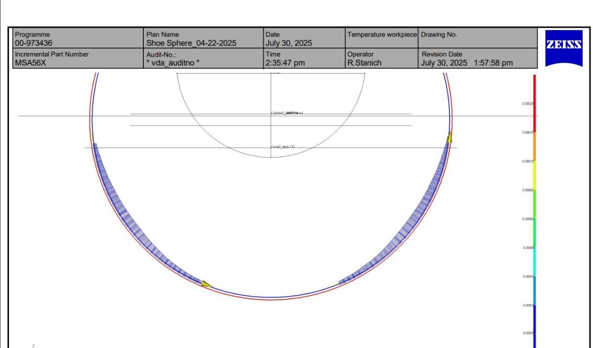

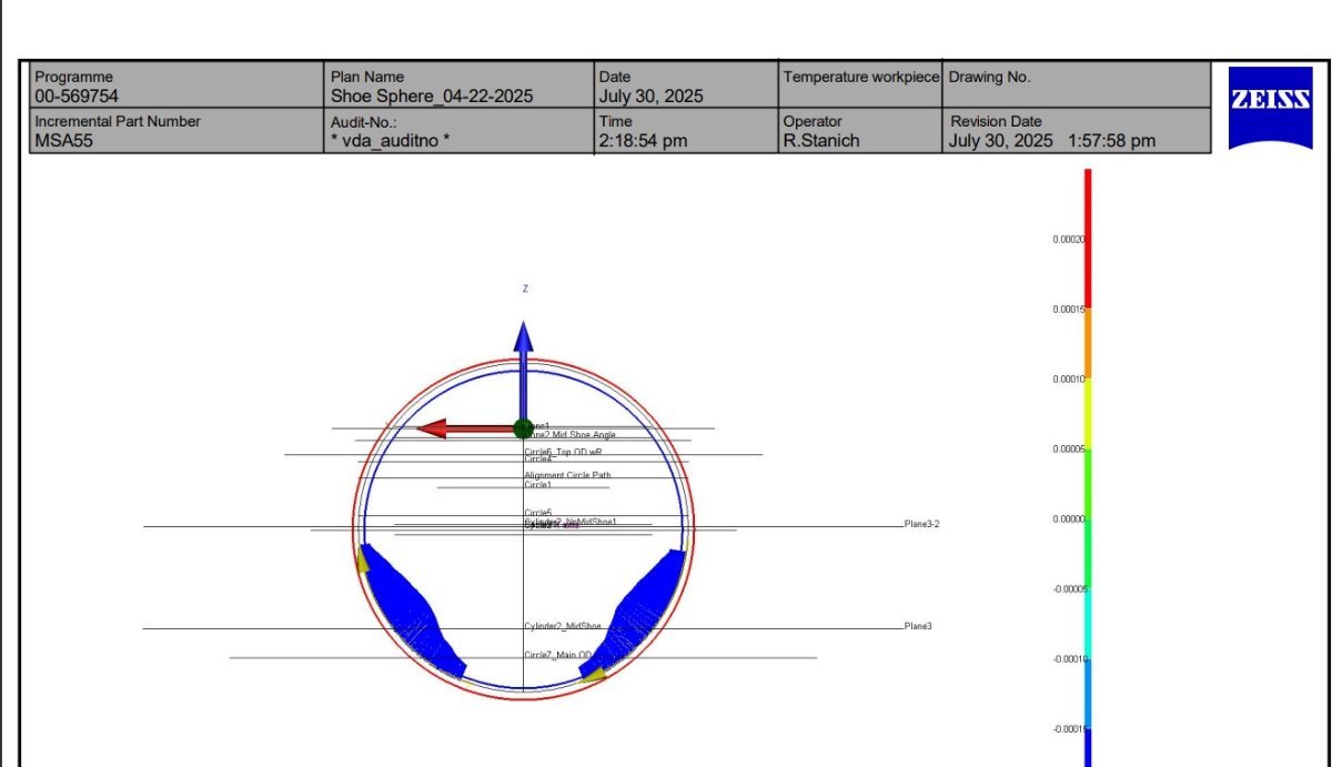

[Ri...] Posted July 30, 2025 Share Posted July 30, 2025 (edited) I am working with Calypso v22017 and PiWeb Basic. We have two graphics on a report with CAD Presentations, at 50x size. The tolerance of the feature is ±.0002" (Inch). What I am experiencing is displaying the bands for Nominal, Max and Minimum along with "Lines" to show the scanned profile. We need 50X or greater to show the bands but don't need the lines to be 50X (or greater). See image: CAD Presentation at 50x.jpg (The lines are greatly exaggerated). See image: CAD Presentation at 10x.jpg (The lines are still exaggerated but the bands are barely legible). Is there a way to make the bands for Nominal, Minimum and Maximum view larger while the Lines representing the scanned feature normal? This particular CAD presentation has about a .00008" deviation from nominal. Edited July 30, 2025 Link to comment Share on other sites More sharing options...

[Ri...] Posted July 31, 2025 Author Share Posted July 31, 2025 I am doing that, but the lines follow the magnification of the Bands, which makes the graph useless. I do not see an option for magnification of the Lines (Blue lines depicting the surface). Link to comment Share on other sites More sharing options...
[Ma...] Posted July 31, 2025 Share Posted July 31, 2025 Oh you were interested in another magnification of tolerance band. Wouldn't it lose it's purpose to show how much it's out of tolerance? Link to comment Share on other sites More sharing options...
[Ri...] Posted August 1, 2025 Author Share Posted August 1, 2025 This is losing its purpose. Its greatly misrepresented at 50x just so we can see the bands. Link to comment Share on other sites More sharing options...
