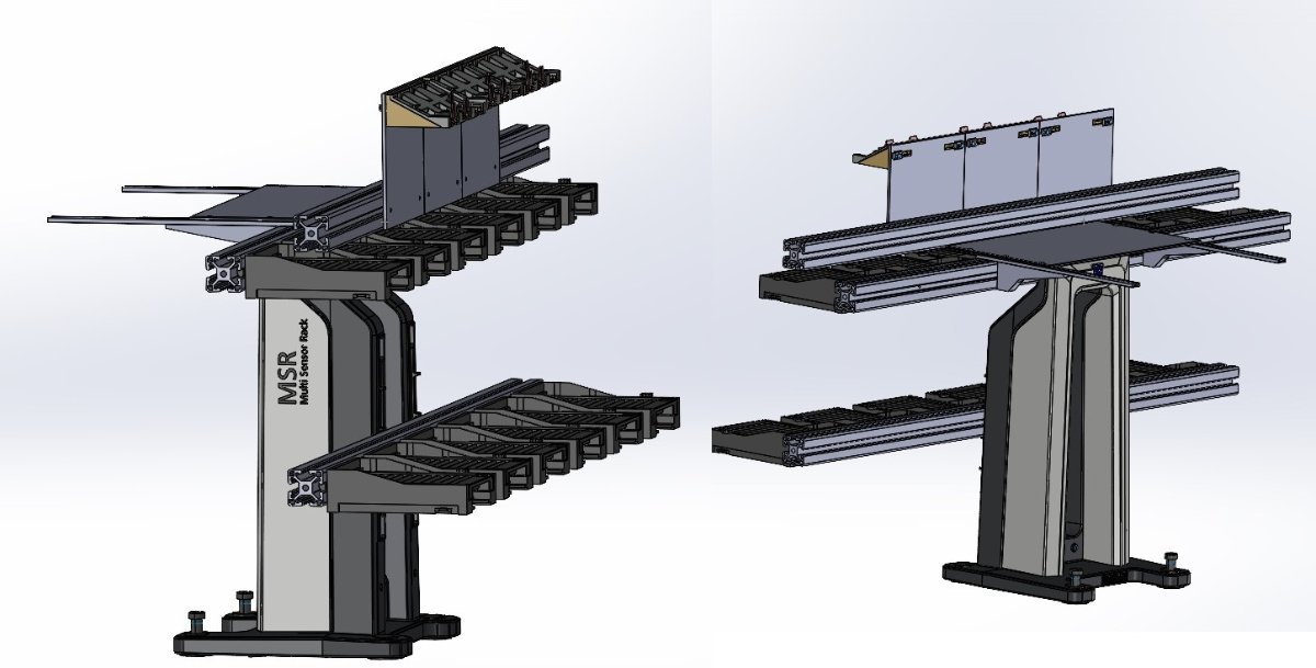

[Ri...] Posted August 1, 2025 Share Posted August 1, 2025 I have worked on this for a little while and now it is almost operational (Testing was successful). This is a standard MSR 2.0 600 Probe Stand with two levels of XTR probes and an added third level that is fully retractable for RDS probes (Manual operation). Of the 9 probes that will occupy the RDS Rack, only one has to be removed prior to Full Forward or Full Retract positions. I may add a PLC and electric motors later for automatic control. Special thanks to Zeiss for the MSR 2.0 and Probe holder models. 👍 3 Link to comment Share on other sites More sharing options...
[To...] Posted August 1, 2025 Share Posted August 1, 2025 Please sign in to view this username. Not to be a party pooper but those holders look like MT holders which are not used with XTR sensor. Close enough for conceptual design though. Link to comment Share on other sites More sharing options...
[Ri...] Posted August 4, 2025 Author Share Posted August 4, 2025 Please sign in to view this quote. You are correct, but they served the purpose for the CAD model. Link to comment Share on other sites More sharing options...
