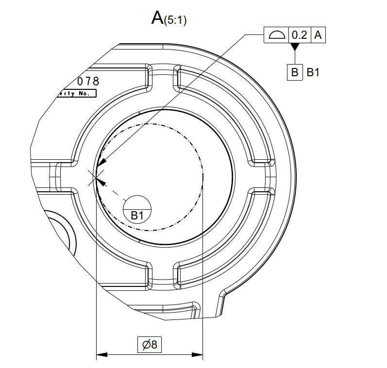

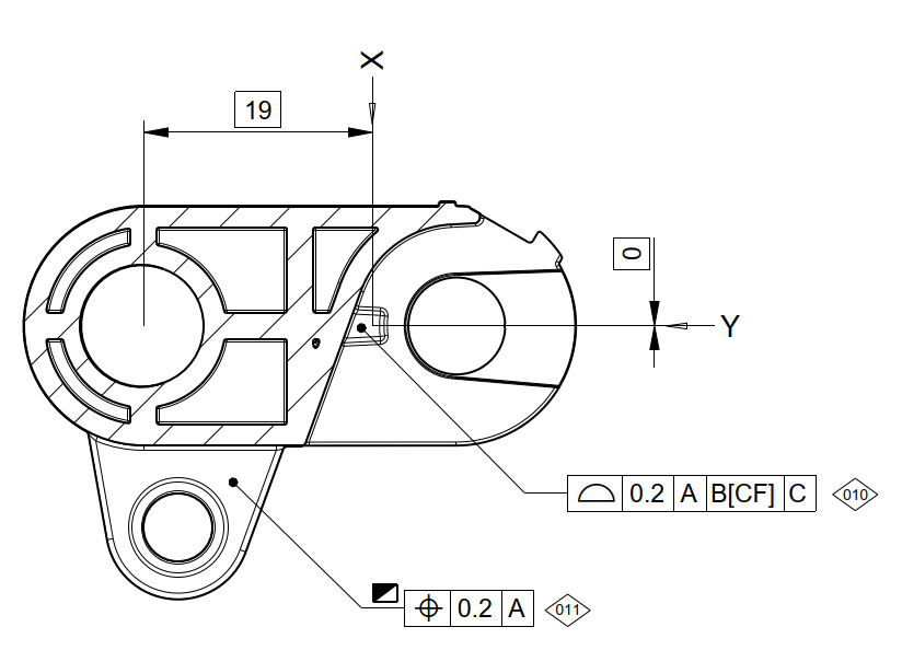

[Ma...] Posted August 4, 2025 Share Posted August 4, 2025 Hi Are there any suggestions how to evaluate contacting features in Zeiss Inspect 3D 2025 according ISO 5459 (e.g. Rule 5 and Annex Example 1) In the attached picture the datum B should not be the axis of the hole, but the contacting line given by B1. Hence the specification of B[CF] in the profile tolerance. I was unable to find any ideas in the help or here in the forum. Thanks for any inputs. Martin Link to comment Share on other sites More sharing options...
[Ma...] Posted August 26, 2025 Share Posted August 26, 2025 Does B contains only B1 point and is it controling only position in one direction? I would imagine in Calypso to have 2d line or recalled points into fixed cylinder with restrained vectors to comply with ISO 5459. Link to comment Share on other sites More sharing options...

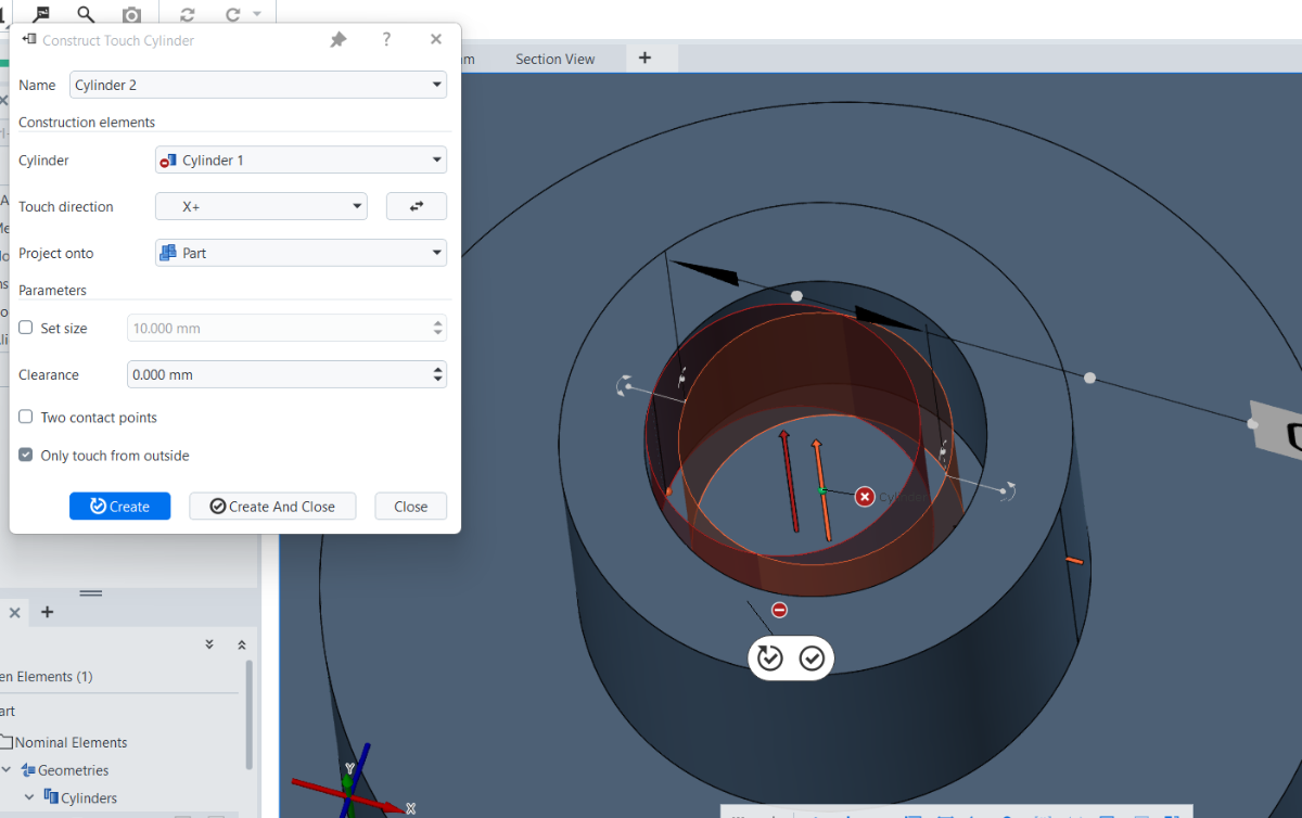

[Di...] Posted August 28, 2025 Share Posted August 28, 2025 Hi Martin, maybe Construct Touch cylinder can help you here. As this does what you need. The drawing is also a bit ambiguous here as well. A better approach would be to use it based on the example from ISO 5459:2024 Figure 24. And in the Note 1 for figure 24 you'll find exactly what the software does here for you. So you can simply add the actual axis of the cylinder cylinder as a datum in the Create Datum Dialog after this workflow. Hope this helps. 1 Link to comment Share on other sites More sharing options...
