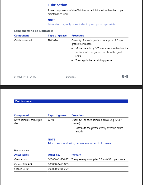

[To...] Posted August 4, 2025 Share Posted August 4, 2025 (edited) Anyone familiar with the part number for the grease used on a DuraMax? Edited August 4, 2025 Link to comment Share on other sites More sharing options...
[Ke...] Posted August 4, 2025 Share Posted August 4, 2025 Tom, I reached out to our Duramax service trainer for more information, but he has a class so it may be a bit before he gets back to me. In the meantime, here is what is shown in the duramax manual: 1 Link to comment Share on other sites More sharing options...
[Ke...] Posted August 4, 2025 Share Posted August 4, 2025 I just heard from him, these part numbers appear to be accurate 1 Link to comment Share on other sites More sharing options...
