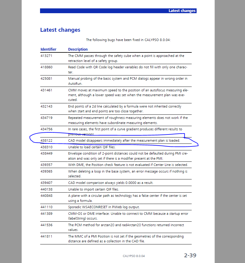

[Ch...] Posted August 6, 2025 Share Posted August 6, 2025 Could be this .. in the latest service pack release notes (2025) but a lot of these are same fixes applied to recent release for 2024, what version are you on ? Link to comment Share on other sites More sharing options...

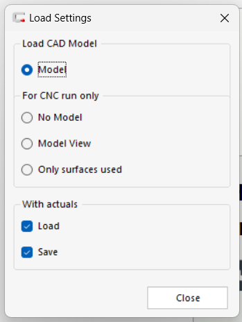

[Ca...] Posted August 12, 2025 Share Posted August 12, 2025 Also, ensure that under File - Load Settings are set to load the model: Link to comment Share on other sites More sharing options...
