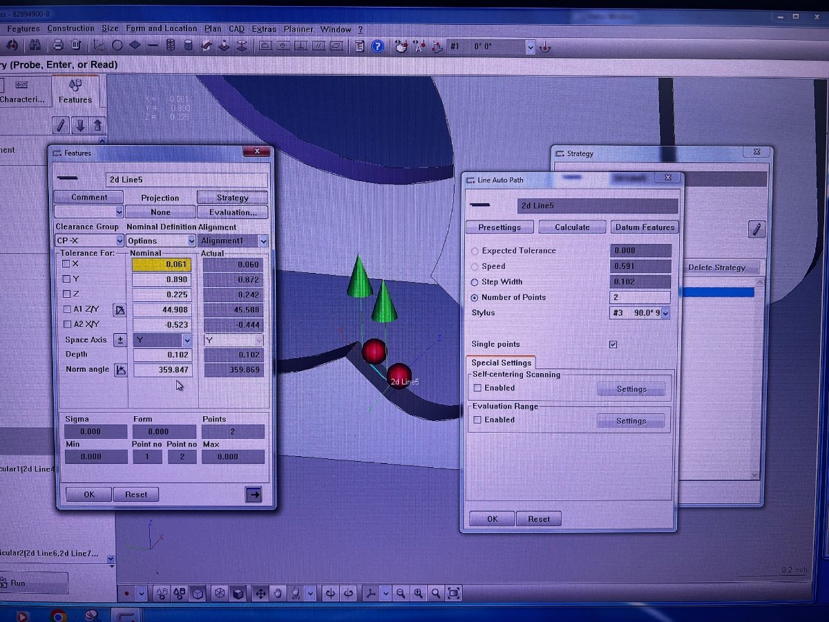

[Do...] Posted August 11, 2025 Share Posted August 11, 2025 How do I correct the vector direction of these arrows so that they show on the screen as being perpendicular to the edge they are measuring to? Link to comment Share on other sites More sharing options...

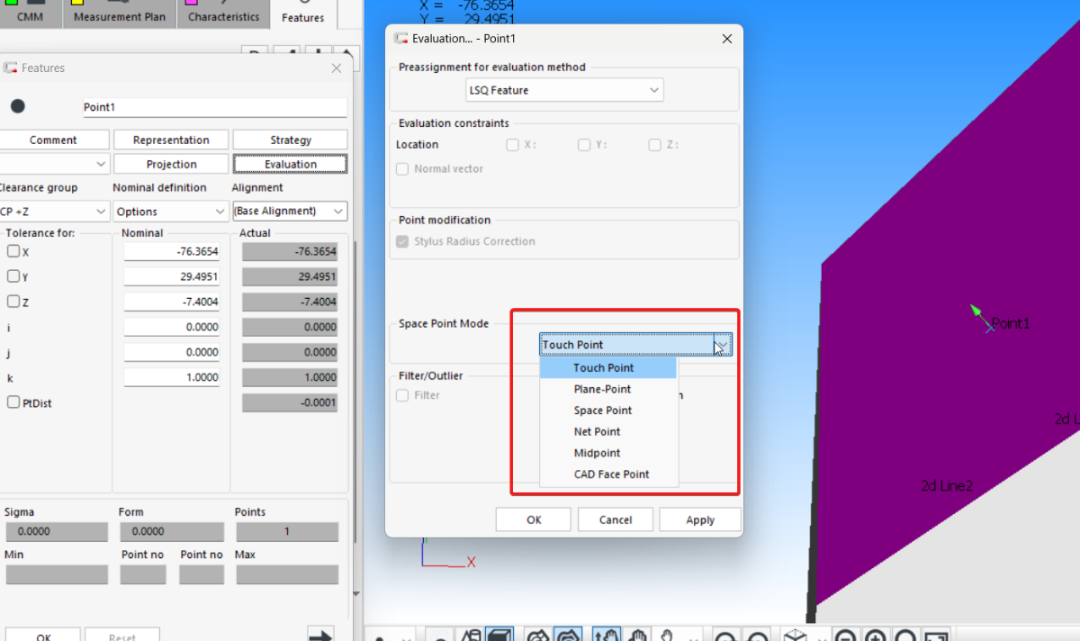

[Ca...] Posted August 12, 2025 Share Posted August 12, 2025 In evaluation what type of point is set? My guess is you will want plane point and it looks like touch point could be set. Link to comment Share on other sites More sharing options...
[Do...] Posted August 12, 2025 Author Share Posted August 12, 2025 Please sign in to view this quote. I am not sure what you mean....................... Link to comment Share on other sites More sharing options...
[Cl...] Posted August 12, 2025 Share Posted August 12, 2025 (edited) Is the line constructed from two points? Or is it a measured line feature? If constructed from two points, go into the evaluation settings of each point and change it in the drop-down on the lower right. Edited August 12, 2025 Link to comment Share on other sites More sharing options...
[Do...] Posted August 12, 2025 Author Share Posted August 12, 2025 Please sign in to view this quote. I have attached a screenshot of the feature. It is a 2D line. Link to comment Share on other sites More sharing options...
[Ma...] Posted August 12, 2025 Share Posted August 12, 2025 What is that "Line Auto Path"? I saw a normal one, where you can define own start/length of a path. Link to comment Share on other sites More sharing options...
[Do...] Posted August 12, 2025 Author Share Posted August 12, 2025 Please sign in to view this quote. The "Line Auto Path" is what is in the measurement "Strategy". Instead of it being two individual points it is shown as a "Line Auto Path" but since the machine is not capable of scanning, the line is comprised of two points with a step width of .102" in between them. Link to comment Share on other sites More sharing options...

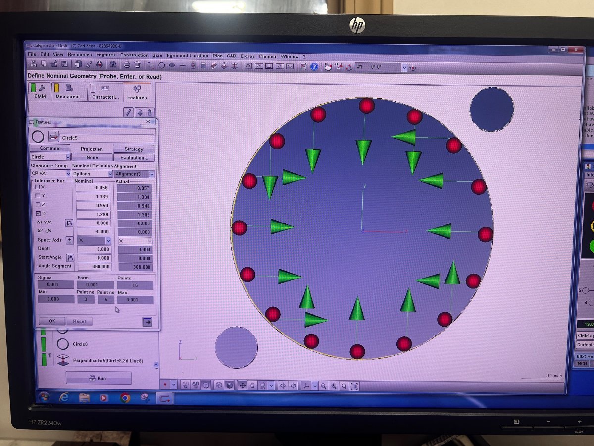

[Do...] Posted August 12, 2025 Author Share Posted August 12, 2025 Please sign in to view this quote. Here is a circle from the same program. It has the same issue. The probe physically travels in the correct direction (normal to the surface) but on screen the actual points shown appear normal to the X,Y,Z coordinate system. Link to comment Share on other sites More sharing options...

[Ha...] Posted August 18, 2025 Share Posted August 18, 2025 Please sign in to view this quote. What Caitlin was referring to is the point evaluation mode. You will find that in the Evaluation window for the feature. You can switch between the different modes depending on the application. https://portal.zeiss.com/knowledge-base?id=1007796 1 Link to comment Share on other sites More sharing options...

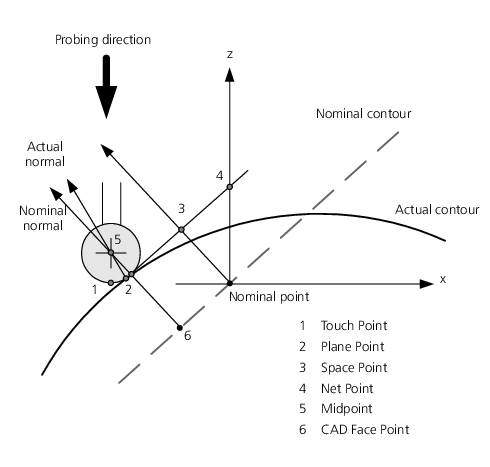

[Jo...] Posted August 19, 2025 Share Posted August 19, 2025 Joseph, I really appreciate you posting that knowledge base article. I didn't know it existed, and it really helps to understand the different types of points. I do have a couple questions though, and I see that you wrote the article. So, who better to ask? Plane Point is described as 'stylus radius correction in the normal vector direction' but doesn't specify nominal normal or actual normal. It would have to be the nominal normal, correct? The point labeled as plane point is shown where the actual normal intersects with the actual contour, but would the actual result be where the nominal normal intersects with the actual contour? Also, I don't fully understand the description of a touch point. My interpretation is this: stylus radius correction will be in the direction of a coordinate system axis. If the probing vector matches the vector of a coordinate system axis, that will be the direction of the radius correction. If the probing vector does not match a system axis, the software will determine the coordinate system axis that is closest to the probing direction and radius correction will be in the direction of that system axis? Is that a correct interpretation? Link to comment Share on other sites More sharing options...
[Da...] Posted August 19, 2025 Share Posted August 19, 2025 I don't think that the evaluation setting for a single point has any effect on straight lines and circles. Looking at Donny Fraser's measurement results, the vector correction seems to work well. Link to comment Share on other sites More sharing options...
