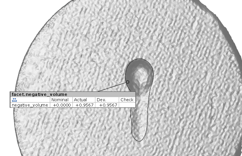

[Já...] Posted August 13, 2025 Share Posted August 13, 2025 I investigate the wear facet on a mesh. I successfully outlined the wear facet on the mesh by using the surface curve function with the snap on the max curvature. Then I need to select this area to make surface comparison to a plane fitted on the unworn plane surfaces. It is very painful that I have to manually select the area within the facet every time, even though it is already encircled. Link to comment Share on other sites More sharing options...

[Se...] Posted August 26, 2025 Share Posted August 26, 2025 Hi, Could be done with scripting -> record a "select on surface" execution and replacing the list of points with the curve points should work. Hope this helps, Sergio Link to comment Share on other sites More sharing options...
[Ch...] Posted August 27, 2025 Share Posted August 27, 2025 Or alternatively you could use the curve to cut your actual mesh into two parts (via Operations->Mesh->Other->Cut Actual Mesh By Curve). Afterwards you can use select patch on your inner area. But be careful, afterwards you have two independent patches similar as you have on CAD. Disclaimer 1: If you have some Creation Command for your mesh (e.g. polygonization parameter etc.) then afterwards they will get lost. Disclaimer 2: If you have some commands that only works on a single patch they will not work on the hole mesh anymore. What are the best approach for your current problem depends on the further inspection that you will fulfill on your project Link to comment Share on other sites More sharing options...
