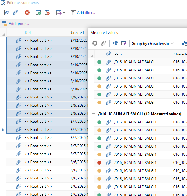

[Ün...] Posted August 18, 2025 Share Posted August 18, 2025 Hello. I'm trying to filter out out-of-tolerance measurements in a Piweb report. Is there an easy way to do this? What am I missing? Thanks. Link to comment Share on other sites More sharing options...
[To...] Posted August 18, 2025 Share Posted August 18, 2025 Go to Resources > Results to file > PiWeb Reporting Configuration > Managing Measurements. Select items to Block or Delete. Link to comment Share on other sites More sharing options...

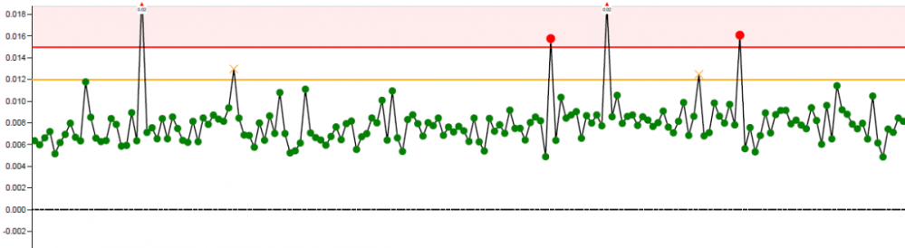

[Ün...] Posted August 19, 2025 Author Share Posted August 19, 2025 Tom, But I need to find and remove the deviant measurements one by one. It would be great if the filtering was done through piweb instead of Calypso. I'd have to spend a lot of time removing 18 deviant measurements out of 500. Link to comment Share on other sites More sharing options...
[An...] Posted August 19, 2025 Share Posted August 19, 2025 This KB article does not cover exactly what you need, but it does point you in the right direction. In the Advanced Filter -> Measured value filter menu that is shown, select Measured values within limit. https://portal.zeiss.com/knowledge-base?id=670464 Link to comment Share on other sites More sharing options...
