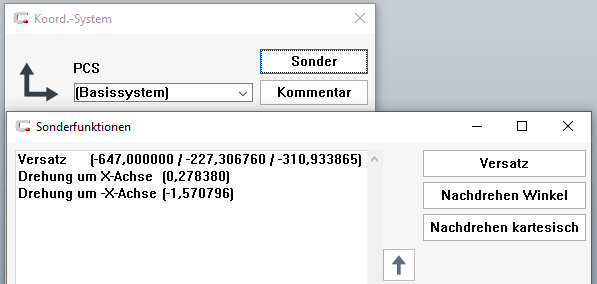

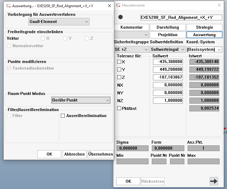

[Ro...] Posted August 18, 2025 Share Posted August 18, 2025 Hi everyone, does anyone know why Calypso calculates actual values and nominal values in different ways? I’m currently trying to reproduce the calculation myself for a special application, but I always end up with the value from the nominal data. Has anyone looked into this before or can explain what’s happening in the background? Example (nominal and actual are the same): After transformation into another Coordinatesystem nominal and actual differ from each other: Link to comment Share on other sites More sharing options...

[Ro...] Posted August 19, 2025 Author Share Posted August 19, 2025 Im not using any feature in the PCS Alignment. Its just a rotation and shift in regard to the basesystem Link to comment Share on other sites More sharing options...
[Ma...] Posted August 19, 2025 Share Posted August 19, 2025 Can you share your setup of PCS? Link to comment Share on other sites More sharing options...
[Ri...] Posted August 19, 2025 Share Posted August 19, 2025 It looks like you rotated your X by approximately 105.95°, and translated 647; 30.39; -1167.8. My suspicion as to why you are seeing a huge difference between the nominal to actual (and PtDist) is due to the evaluation parameter of the Point. I assume it is a Space Point? If so, please switch to Plane Point. 1 Link to comment Share on other sites More sharing options...
[Ro...] Posted August 22, 2025 Author Share Posted August 22, 2025 Sorry for the late reply. This is the PCS Setup This is the point. The evaluation parameter is a (for the lack of a better translation) "touchpoint" Link to comment Share on other sites More sharing options...
[Ma...] Posted August 22, 2025 Share Posted August 22, 2025 From your posted screens i would suggest to look what axis are used in primary/secondary and pehaps features. Also - wouldn't rotation in +X and +0,27... and -X and -1,57... be same like +X +1,84...? But this come from drawing and views i suppose. Rotating in X axis will transform your Y and Z vector on that point, but just a little, not like almost 90° Link to comment Share on other sites More sharing options...
