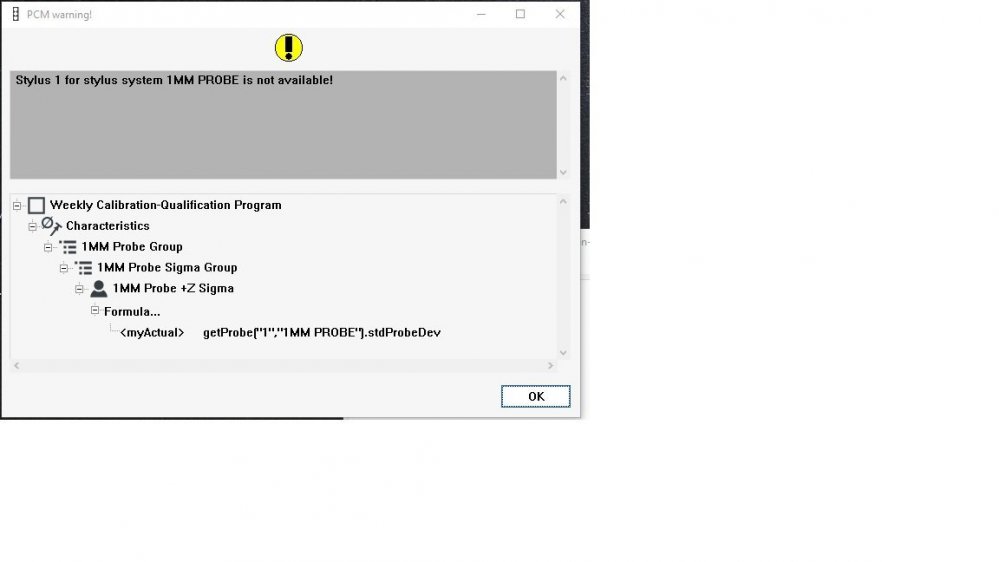

[Na...] Posted August 18, 2025 Share Posted August 18, 2025 I have the result elements added to my weekly qualification. I am trying to have it give me a report with the sigma and radius of each stylus. When I tried running it kicked this error and made the stop light go red. Is this due to not having a PCM license? Link to comment Share on other sites More sharing options...
[Ri...] Posted August 18, 2025 Share Posted August 18, 2025 You have a naming error for stylus 1 in your PCM. 1 Link to comment Share on other sites More sharing options...
[Na...] Posted August 18, 2025 Author Share Posted August 18, 2025 That was exactly the issue, I was using the stylus number not the name. Thank you for the help. Link to comment Share on other sites More sharing options...
