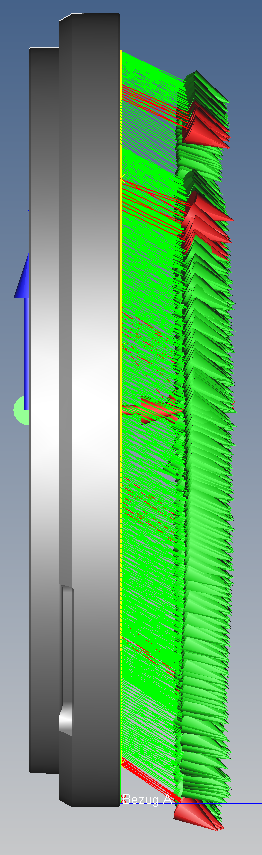

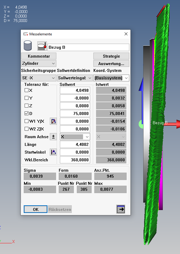

[Se...] Posted August 20, 2025 Share Posted August 20, 2025 Hello, i have a Problem with Vektors when i Scan the part: they shoud be straight, but there are in Angle. the same goes with circle or Cilinder: if i switch to single Points the Vektors are OK. if i make a measurment from +Z Axis, the Scan is also OK. i made this measurment on ZEISS Duramax. if i use the same Programm on a Prismo the Vektors are also OK. hase anybody hade such Problem and knows what is the issue? Thanks Peter Link to comment Share on other sites More sharing options...

[Ke...] Posted August 20, 2025 Share Posted August 20, 2025 (edited) Please sign in to view this quote. "When analyzing data taken from an XXT probe, it is important to take into account that side probes on the XXT can have unexpected deviations of the normal vectors. This happens because the XXT probe takes points based on a deflection trigger. Once the probe senses a deflection of a certain amount, it takes a point. If the stylus tip of the probe is in a different axis than the orientation of the XXT, this creates a cantilever which will effect the direction of the normal vector" "This is expected behavior and does not effect the calculation of the data as CALYPSO uses, by default, the nominal normal directions in the geometry of the feature itself to calculate radius correction." Edited August 20, 2025 2 Link to comment Share on other sites More sharing options...
[Cl...] Posted August 20, 2025 Share Posted August 20, 2025 I've seen this when a slightly overweight or out of balance start probe is used. Link to comment Share on other sites More sharing options...

[Se...] Posted August 21, 2025 Author Share Posted August 21, 2025 Please sign in to view this quote. Thank you for feedback. so that means that nothing is wrong with XXT Head? Link to comment Share on other sites More sharing options...
[Ke...] Posted August 21, 2025 Share Posted August 21, 2025 Please sign in to view this quote. Correct. Link to comment Share on other sites More sharing options...
