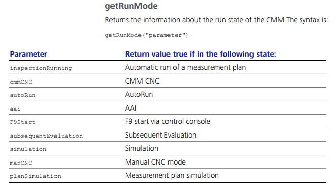

[Ri...] Posted August 21, 2025 Share Posted August 21, 2025 Is there any way of knowing that the measurement was handled as a subsequent evaluation? I know that I could leverage the serial number of the machine if it was done on an offline seat (look for 00000), but I don't think that applies to subsequent evaluation on a live machine. It's possible to maybe just leverage the incremental part number to see if it ends with "_SE", but I'd like to hear if there is a more concrete way. Any and all help is greatly appreciated. Link to comment Share on other sites More sharing options...
[Ma...] Posted August 21, 2025 Share Posted August 21, 2025 I have time of a measurement on protocol. When reevaluated, then time is zero. 1 Link to comment Share on other sites More sharing options...
[Ch...] Posted August 22, 2025 Share Posted August 22, 2025 Please sign in to view this quote. usually the way I can tell as well when time is < 1 min, etc. I'll see if there is some PCM Flag we can check as well.. 1 Link to comment Share on other sites More sharing options...
Popular Post [An...] Posted August 22, 2025 Popular Post Share Posted August 22, 2025 (edited) Edit: *** Unless you're determining a previous run was a subsequent evaluation... then I'm out to lunch! Hah! *** This should get you going: if getRunMode("subsequentEvaluation") then // handle subsequent evaluation endif Edited August 22, 2025 5 1 Link to comment Share on other sites More sharing options...
[Ri...] Posted August 22, 2025 Author Share Posted August 22, 2025 Please sign in to view this username. Well that was super simple. Looks like I should have just read the user manual. Lol. Thank you so very much! Link to comment Share on other sites More sharing options...
