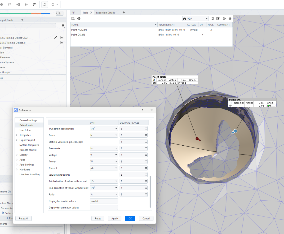

[Aa...] Posted August 25, 2025 Share Posted August 25, 2025 Hi Everyone, Somebody asked me if I could check if a clip on a plastic part is present or not. This would be for a production line inspection every two hours. Is there an easy way to do this? I can create a 'surface point' on the relevant clip and check for deviation in distance. Then I can give the check an arbitrary tolerance. But if the clip is missing I get a result like this --> '???'. I'm really looking for a 'Fail' statement if there is no scan surface data at the relevant location, and a 'Pass' statement if there is. I'm running GOM Inspect 2018. Any ideas? Link to comment Share on other sites More sharing options...

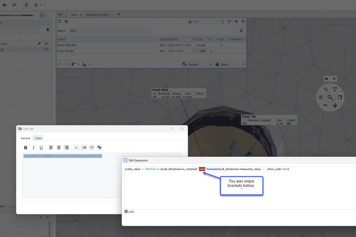

[Na...] Posted August 26, 2025 Share Posted August 26, 2025 Hi Aaron, it is possible to define the output for invalid values in the preferences. This will be shown instead of '???': For a 'Pass' statement, you could alter the expression in the VDA table template for example, to show abritary text. ('valid' in my example): In the QDAS export with the new QDAS certified App (needs Inspect 2025 though) the output can be defined in the configuration for example, if the results are exported. Nanno Link to comment Share on other sites More sharing options...

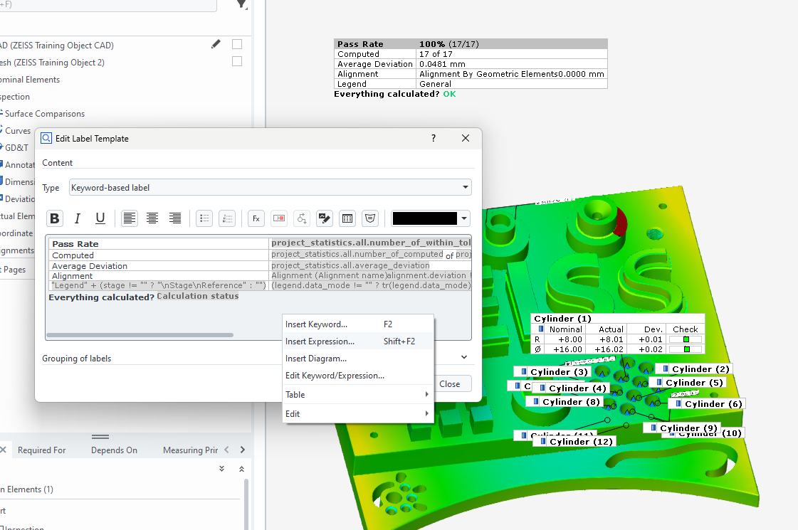

[Aa...] Posted August 26, 2025 Author Share Posted August 26, 2025 Let me give you this scenario: Let's say there are like 20 to 30 checks for a production line inspection for a single part. I can have all these checks listed in a table in a pdf report. And then an operator can run the inspection using Kiosk mode and get the report with that table of inspection results. But often I think it is better to have one statement of GO/NO-GO that indicates whether all the checks passed, or if one or more failed. Is there an easy way to implement that? Link to comment Share on other sites More sharing options...
[Na...] Posted August 27, 2025 Share Posted August 27, 2025 Yes, it is possible to count invalid elements and define an output if more than one element is invalid. There is a keyword for "Number of computed elements" for example, which is used in the Result label of an annotation (inspection -> annotation). Link to comment Share on other sites More sharing options...
[Aa...] Posted August 27, 2025 Author Share Posted August 27, 2025 How do you check if all the toleranced items passed? Is it like this? Number_of_toleranced_attributes - Number_of_attributes_within_tolerance = 0 Link to comment Share on other sites More sharing options...
[Na...] Posted August 28, 2025 Share Posted August 28, 2025 Here is an example with the used keywords from the "Result" label of the annotation: Expression: #@ Calculation status ok = format ('OK' , "+98.11", show_unit=false, color=color ("#13d373ff")) nok = format ('NOK', "+98.11", show_unit=false, color=color ("#ff0000ff")) if project_statistics.all.total_number != project_statistics.all.number_of_computed: return nok else: return ok The name of the keyword is a bit misleading: it works for visible elements, so it has to be placed in a 3D view with all elements visible (visible means the eye symbol in the explorer is checked). Link to comment Share on other sites More sharing options...
