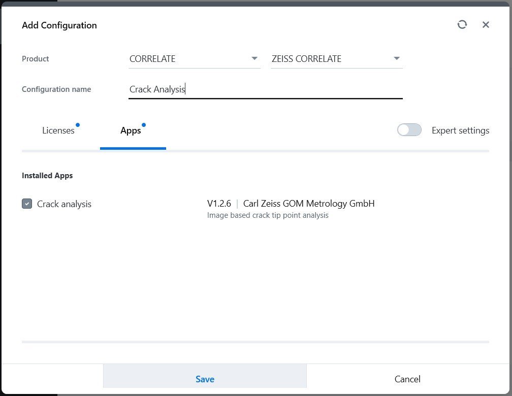

[Ah...] Posted Tuesday at 04:14 AM Share Posted Tuesday at 04:14 AM Hello everyone, I am new to ZEISS Correlate and would like to ask whether the software can measure crack length frame by frame from captured images during a test. I have a sequence of images with a clear crack path. I know the fixed starting reference point, and I can visually identify the crack tip moving in each frame. What I want to achieve: Define one fixed reference point that remains constant in all frames. Define one moving point (crack tip) that the software automatically tracks across all frames. Have ZEISS automatically calculate and export the distance between these two points for each frame (crack length vs time). It would be very helpful if someone could recommend the workflow in ZEISS Correlate to set up this measurement and explain how to export the distance values for all frames as CSV/Excel. Thanks in advance! Best regards, Khawaritzmi Link to comment Share on other sites More sharing options...

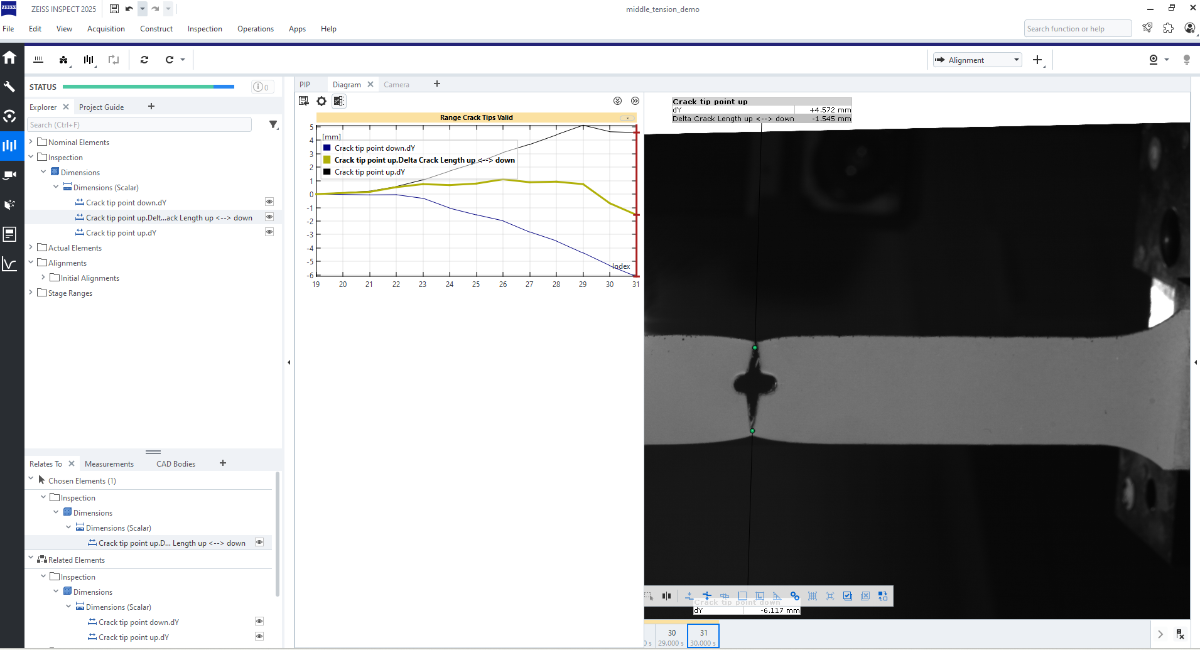

[Mo...] Posted Tuesday at 07:45 AM Share Posted Tuesday at 07:45 AM Hello Ahmad, There is actually an app in our software store that you can download and run. It detects the crack tip and the script follows it. Here: ZEISS Quality Software Store As you can see: Then find the desired inspection (length of the crack tip) on the left side of the explorer. You can then export it by selecting it and going to “File -> Export -> Step Data” and then exporting it. Best regards Mohamed Link to comment Share on other sites More sharing options...

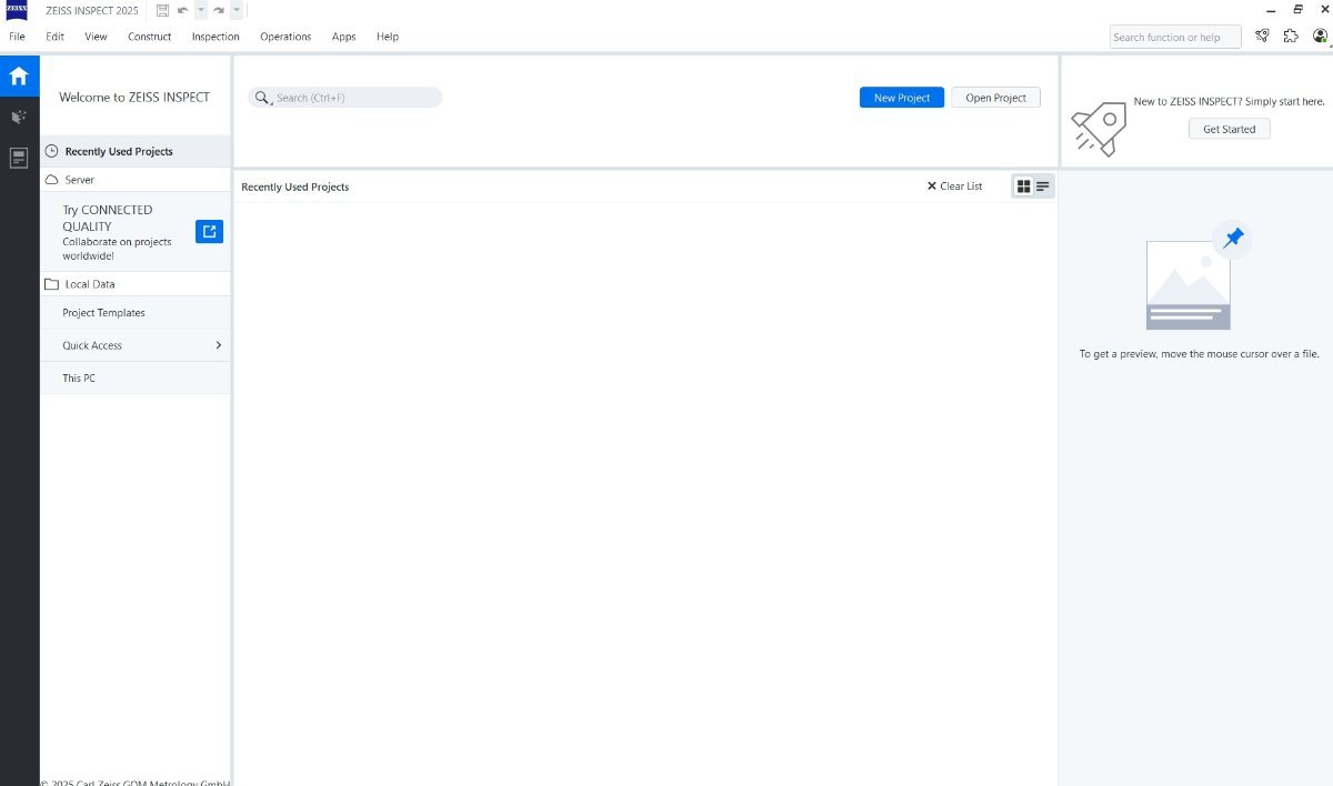

[Ah...] Posted Wednesday at 02:54 AM Author Share Posted Wednesday at 02:54 AM Hi Mohamed, Thank you for your reply and help! I have installed Crack Analysis v1.2.6 via ZEISS Quality Suite → Applications → Add Configuration (see screenshots). I then launch ZEISS INSPECT 2025 with that configuration, but I can’t find where to open or run the app inside INSPECT. Could you please share a step-by-step guide on: Where the Crack Analysis tool appears in INSPECT (exact menu or path to launch it). How to use the Crack Analysis tool in INSPECT. How to start crack-tip detection on an image sequence and set the fixed reference point and moving crack tip. Any notes on version/licensing (I’m using INSPECT 2025 Correlate - Free). If you have any tutorial, documentation, or screenshots showing the workflow, that would help me a lot. Best regards, Ahmad Link to comment Share on other sites More sharing options...

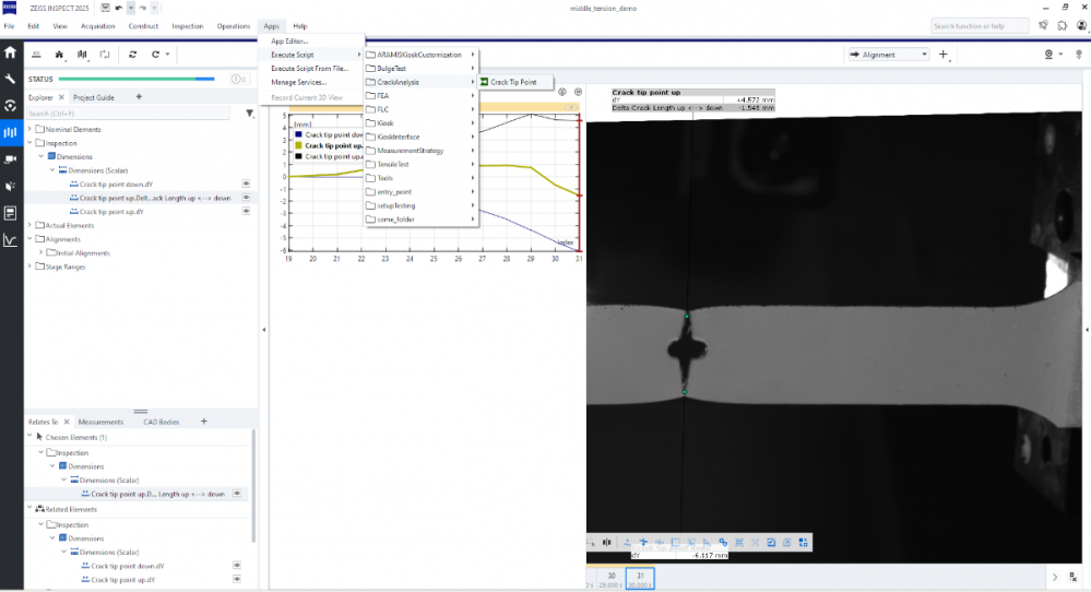

[Mo...] Posted Wednesday at 06:55 AM Share Posted Wednesday at 06:55 AM Hello Ahmad, After downloading the app website, you can install the app in the software using drag & drop (after opening Correlate). You will then find the app in the menu under “Apps,” as shown in the attached image. Please find attached a PDF file with further details. Best regards Mohamed Crack_Propagation.pdf Link to comment Share on other sites More sharing options...
