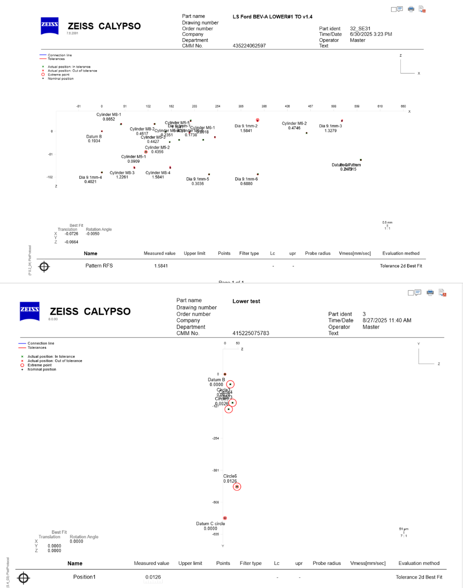

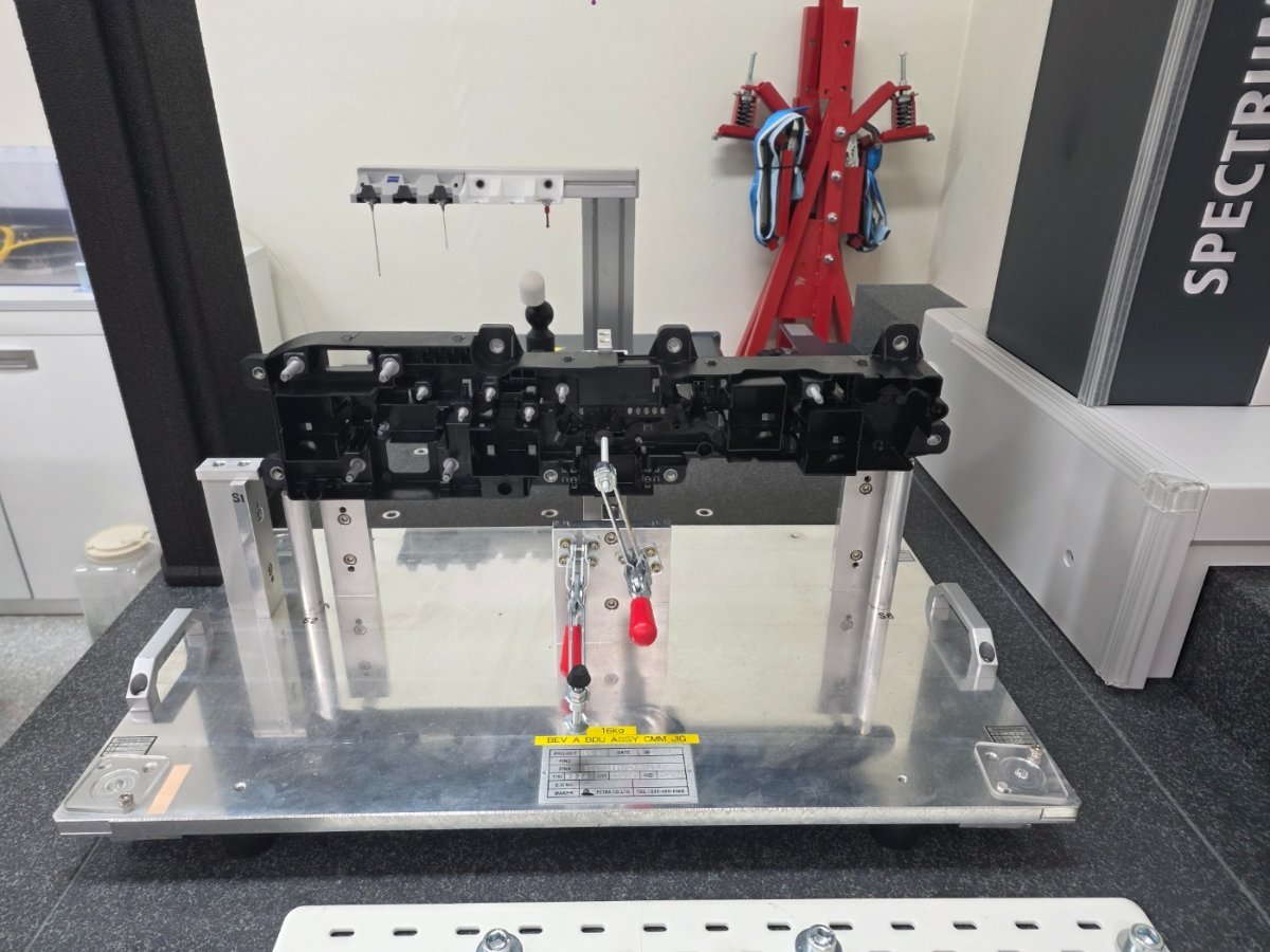

Hello.

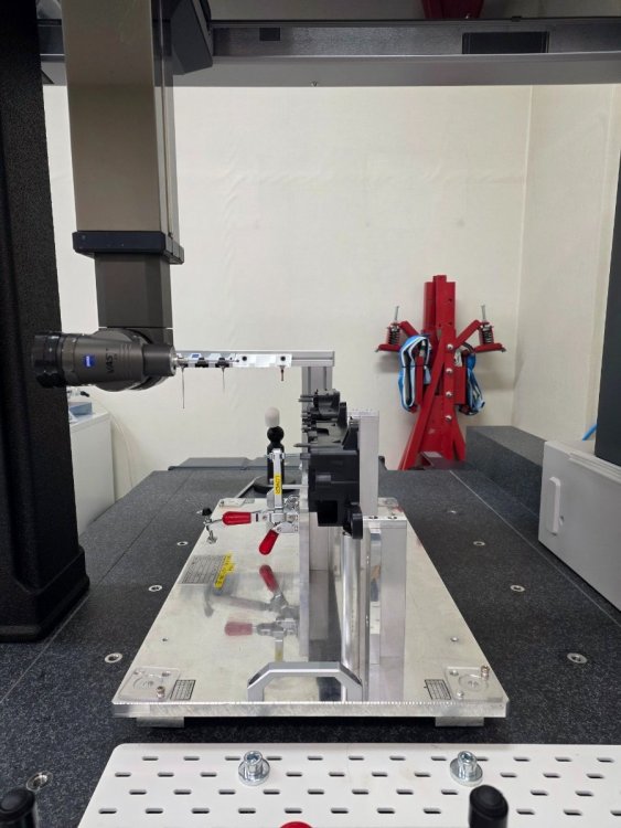

I have a spectrum verity 2025 (size 1000*700*600)
I'd like to put and measure it in the way in second picture.

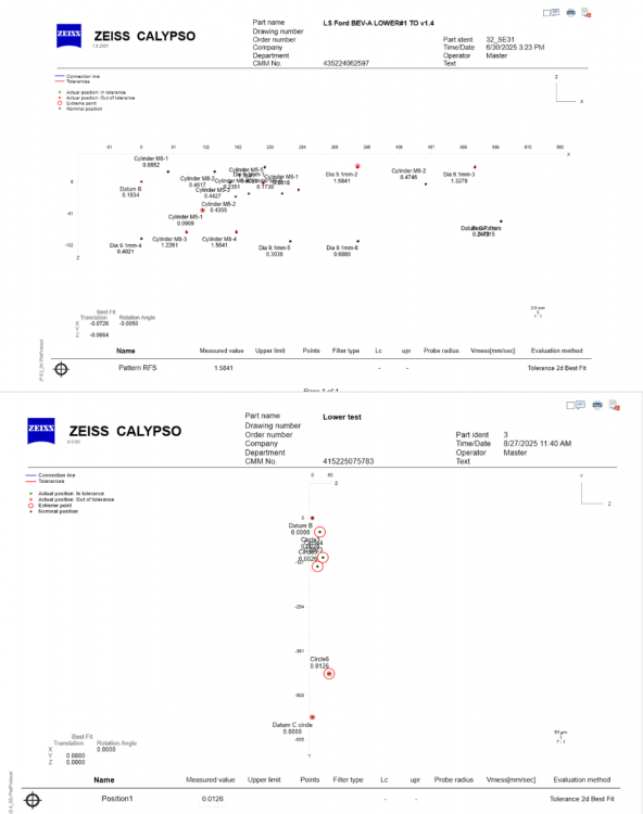

In this way, I got very strange result graph which is in mirrored in axis and there is no way to modify it in plot report.
I tried to modify base alignment x,y,z axis too, but I got same strange result ( just axis alphabet was changed, e.g. x -> y, y-z)
When the part faces to -y axis (cmm front side), I can get a normal result report.
It seems like there is certain logic for bore pattern.
Is there anyone who knows how to solve this issue?
KakaoTalk_20250827_151846011.thumb.jpg.d1a09e88abe354234cdfaee0ad747cb6.jpgKakaoTalk_20250827_151109332_01.thumb.jpg.10111b1435072ffed202c13be6ff5ace.jpgKakaoTalk_20250827_114432938.thumb.png.2158b6ea1f3732e9507295363b56e311.png
You can use right mouse button into a graph and select direction instead of AUTO to your desires.
Unfortunately only way to make this automatic would be protocol template specific for program ( to force this selection )
