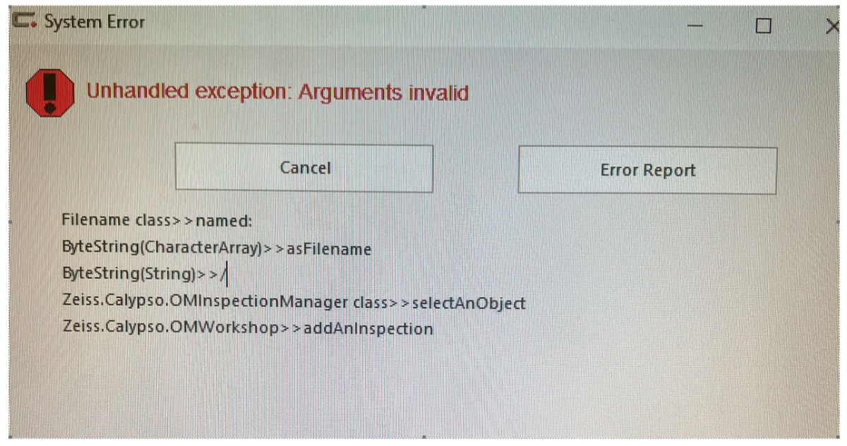

[Gu...] Posted August 29, 2025 Share Posted August 29, 2025 Hello everyone, I'm very new to the programming world so I apologize in advance if I'm being ignorant on the topic. I'm hoping someone could point me in the right direction for this error I'm getting (in the title). I open up calypso, try to open a file and that's the error I get. I can start a new measurement plan just fine but can not access any pre existing programs. This started after I was building a qualification program (RDS) and it started acting odd with the probing points on the sphere. So I restarted the program and computer and it did not fix the probing issue. Then I shut down the entire CMM (Prismo, Calypso 2023) and when I opened everything back up this is when the error started to occur. This could be a simple fix that I'm missing or complex, not real sure. If I'm missing any critical information about my machine let me know and I will try to provide whatever I can. Any help would be appreciated, thank you. Link to comment Share on other sites More sharing options...
[Je...] Posted August 29, 2025 Share Posted August 29, 2025 We are missing a critical piece of information needed to identify the problem. Can you provide the error message details please. Link to comment Share on other sites More sharing options...

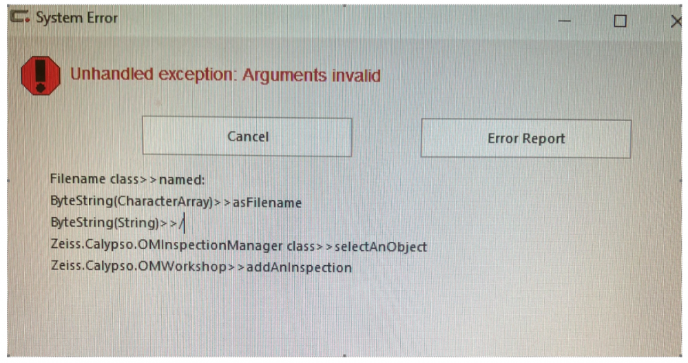

[Gu...] Posted August 29, 2025 Author Share Posted August 29, 2025 Link to comment Share on other sites More sharing options...
[Gu...] Posted September 2, 2025 Author Share Posted September 2, 2025 Also, I might add this morning when I was trying to find a solution I noticed my measurements in the environment settings were defaulted back to mm and degrees back to C. Looks as if it may have gone back to all original settings? Link to comment Share on other sites More sharing options...
[Je...] Posted September 4, 2025 Share Posted September 4, 2025 This appears like you may have an illegal character in the filepath, inspection name or base alignment. Make sure you are using standard characters with no special characters or alt-codes. Link to comment Share on other sites More sharing options...
