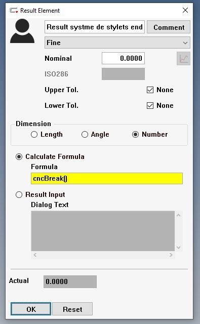

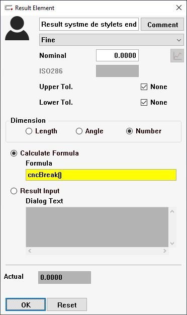

[Se...] Posted September 1 Share Posted September 1 Hello, everyone !😀 I want to do the following in CALYPSO: When a specific Result Element is reached, Save the results of all characteristics measured up to that point as a PiWeb PDF automatically to this folder: After saving, run cncBreak() to stop CNC and wait for the operator. Right now, I already use cncBreak() in the Formula and it works. But I don’t know how to add the automatic PDF save before the break. Could someone please give me an example PCM code for this? Thanks in advance! Link to comment Share on other sites More sharing options...

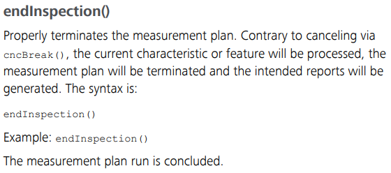

[An...] Posted September 2 Share Posted September 2 Could consider using endInspection() instead of cncBreak() to get the report? Should still redlight the machine, but more gracefully & still generate the reports from whatever was measured & evaluated. 2 Link to comment Share on other sites More sharing options...

[Se...] Posted September 2 Author Share Posted September 2 (edited) Please sign in to view this username.  Please sign in to view this username.  Sorry, I didn’t explain it clearly before. I first tried using endInspection(). But since our setup is not just Calypso and it is connected to the conveyor app, ending with endInspection() makes the conveyor think the result is OK, even when it is actually NOK. That’s why I had to use cncBreak() instead.  So I am looking for a way to use cncBreak(). Is there a way to save the results into the folder C:\ACCURA\RESULTS_PDF Edited September 2 Link to comment Share on other sites More sharing options...

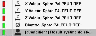

[Se...] Posted September 15 Author Share Posted September 15 (edited) Please sign in to view this quote. Hellp, Please sign in to view this username. I just came back from vacation, and I have a question regarding my setup. In the first picture, if the X, Y, Z or Dia value is NOK, the 5th RESULT element will be executed. Before this RESULT element runs, I would like to save the current results as a PDF in the Postsetting step, and then execute cncBreak(). Is there a way to achieve this workflow: NOK → save PDF → cncBreak? Thank you in advance for your help! Edited September 15 Link to comment Share on other sites More sharing options...

[Ch...] Posted September 15 Share Posted September 15 Also for reference, I know you said endInspection() doesn't work for your application but there seems to be these variables for endInspection(): endInspection("WITH_DATA_OUTPUT") endInspection("NO_DATA_OUTPUT") Â Link to comment Share on other sites More sharing options...

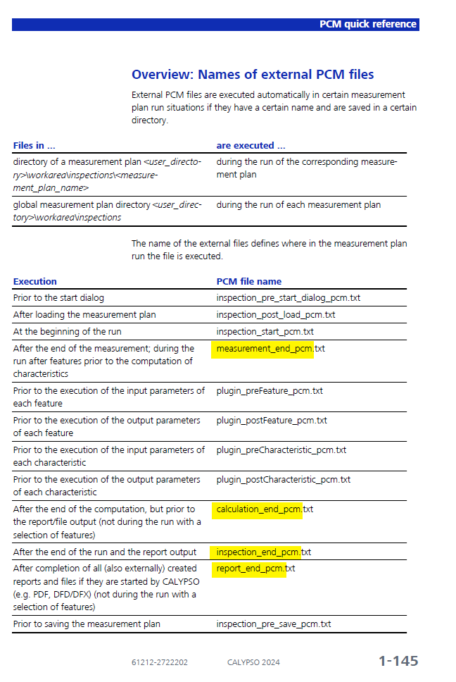

[Ch...] Posted September 15 Share Posted September 15 Hmm, seems possible with PCM but is obviously undocumented and would likely require 'executeCode'. PiWeb looks like it requires initalization/syncronization etc. I'd suggest asking Zeiss for a solution or one of the PCM wizards here. PCM is likely in this area : Zeiss.Calypso.OMMeasProt multiOutput but also Zeiss.PiWeb.OMPiWebCMM. Â Link to comment Share on other sites More sharing options...

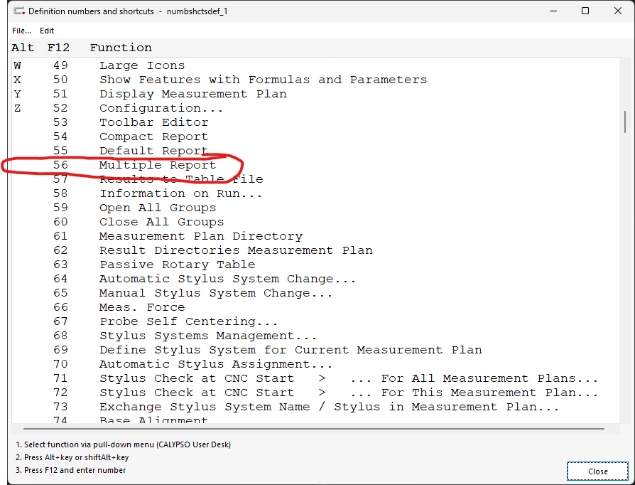

[Ri...] Posted October 31 Share Posted October 31 I mean, technically the program does not have to finish for PiWeb to be executed. I have personally tested this in a completely manual process by going through each Characteristic, and then going to View - Multiple Report. This will push data to PiWeb - both local and server. Having said that, I guess you could run something to process the characteristic (or maybe even just run from the Characteristic side) like "display(getActual("characteristic-name").deviation)". Then you would just need to trigger the View - Multiple Report. It is already a named function. 1 Link to comment Share on other sites More sharing options...
