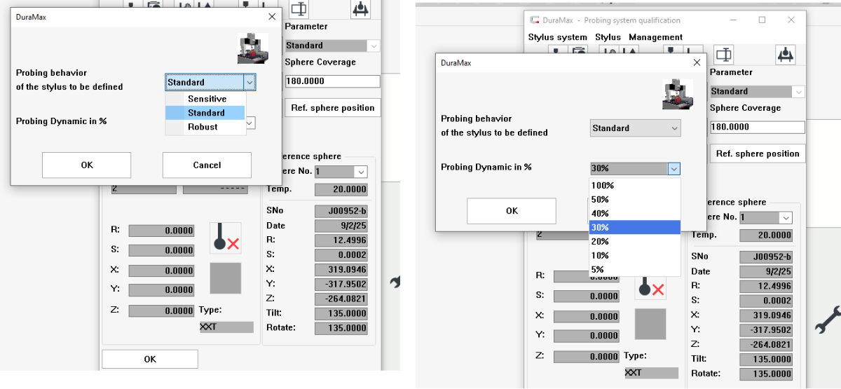

[Ma...] Posted September 2, 2025 Share Posted September 2, 2025 Does anyone have knowledge about which of the following settings to choose in which situation? Is the contact dynamics related to the elasticity of the measured material (the more deformable it is, the lower the dynamics), and how should one generally approach this topic? Currently, we use styli of various lengths (from a few millimeters up to 1000 mm), and we mainly measure steel, occasionally aluminum. We use traditional ruby tips as well as disk styli. I’d be grateful for any help, because at the moment I’m doing this by intuition and I don’t really understand how it affects the final result. Link to comment Share on other sites More sharing options...

[Ma...] Posted September 2, 2025 Share Posted September 2, 2025 I am not sure how on Duramax, but Dynamics will result in slower approach speed and pressure. It's mostly used on long and flexible probes and/or flexible material, like plastics or sheets of metal. Using different probing behaivour will result in different macro for qualification. You can tryout different probing behaviour to see. You can also tryout different dynamics, but i can not advise you to choose 100% for long brittle probe. Pick a certified ring used for discs and see how is your reported diameter and other things changing. 1 Link to comment Share on other sites More sharing options...

Popular Post [Ma...] Posted September 7, 2025 Popular Post Share Posted September 7, 2025 This might help Understanding Probing Behavior and Probing Dynamics in ZEISS Calypso.pdf 4 1 Link to comment Share on other sites More sharing options...

[Ri...] Posted September 8, 2025 Share Posted September 8, 2025 The Probing Behavior that you select during Qualification has no impact on the Qualification itself. It will, no matter what, still perform a Passive Qualification at all three "forces". The only thing setting the Probing Behavior at the time of Qualification does is set the default behavior of measurement for every feature strategy that uses that tip - you can always still go back to Resources - Features Settings Editor and change the behavior. The probing dynamics is a huge box of things because I would say that it depends on the machine, and what you are trying to measure. For DuraMax and O-Inspect (non-air bearing machines) we've always recommended a 30% probing dynamics across the board. One thing that would cause you to drop the probing dynamics to an even lower value is the size of the feature you are trying to measure, and the direction you are coming from. I'm not certain you've picked up on the fact that the XXT works via deflection of the mechanical spring inside of it. If you probe from the radial directions (+Y, +X, -Y-, -X) a lot of times you will see if kind of "wiggle" on the surface when it makes contact (you can also sometimes see this probing in the -Z direction as well). If it is a large surface (like something on the CAD Cube) it probably doesn't matter, but if you are trying to measure a tiny land, then you could potentially run into issues (especially as the probe size gets smaller and smaller). 3 Link to comment Share on other sites More sharing options...
