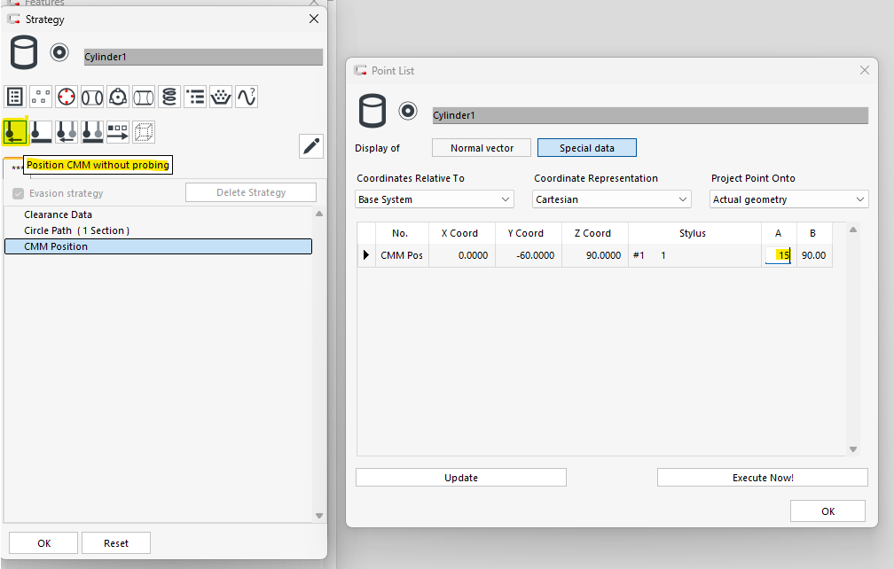

[Ch...] Posted September 3, 2025 Share Posted September 3, 2025 It may take some playing around but I do like Wojciech Malig's CALYPSO: Sub-Clearance Planes idea. I can't recall if the the RDS will rotate near a sub-clearance plane or if it may want to clear up to the parent clearance plane first but maybe if you pair that idea with some CMM Position points in which you set the RC-CAA angle to rotate right after the Circle Path scan? Scan the Circle Path with A0 B90 and then right afterwards set the CMM Position point to different A value (i.e. 15) maybe you can control the rotations a bit more. Or if your program allows for it you could try placing a CALYPSO: Rotate/Swivel Position inside the part however if other areas of the program require rotations this may not be very practical. 1 Link to comment Share on other sites More sharing options...

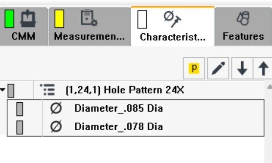

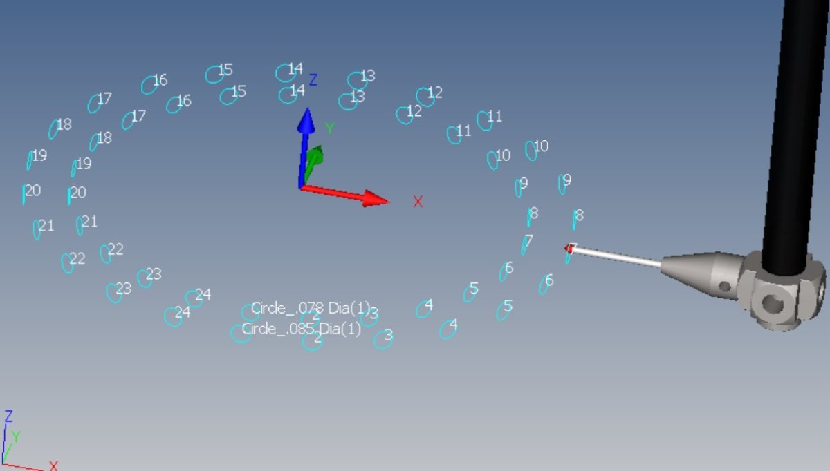

[To...] Posted September 3, 2025 Share Posted September 3, 2025 Here's program I did where I measured 24 pairs of inline holes using a pattern. The stylus was an "L" stylus with 24 qualified positions. Note: the "Auto2: Shaft along normal" stylus used in features. I used sub-clearance planes to keep probe down to measure both inline holes, but because I couldn't rotate the "A" angle below the clearance plane, I had to use position points control all positions, including to move above +Z for indexing. I also had to run via "Characteristics list" so the patterned group would force it to measure both inline holes before indexing. pattern with RDS 2.zip Link to comment Share on other sites More sharing options...
[Jo...] Posted September 4, 2025 Author Share Posted September 4, 2025 Very interesting! I appreciate the response so much! I think using position points will get me where I need to go (and be a relatively safe way to get there). I am working on a similar problem, and it is the L probe not seeming to work well with Auto: shaft along normal". I need to play around with that more because it should do what I am looking for, and I am ending up with a bunch of PCM to assign rotations id rather get rid of. Link to comment Share on other sites More sharing options...

[Jo...] Posted September 18, 2025 Author Share Posted September 18, 2025 Please sign in to view this quote. I am having some success with this strategy! I really appreciate pointing me on the right path! 1 1 Link to comment Share on other sites More sharing options...
