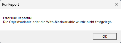

[Ro...] Posted Wednesday at 07:27 AM Share Posted Wednesday at 07:27 AM Hello, after getting a new workstation, Excel export in Calypso 2024 no longer works on this computer. An error message appears " the object variable or the with block variable was not set" The basic settings are the same as on the other computers where it works. How can I fix this? Link to comment Share on other sites More sharing options...
[Ke...] Posted Wednesday at 10:50 AM Share Posted Wednesday at 10:50 AM Please sign in to view this quote. Silly question... does your new workstation have Excel installed? Link to comment Share on other sites More sharing options...

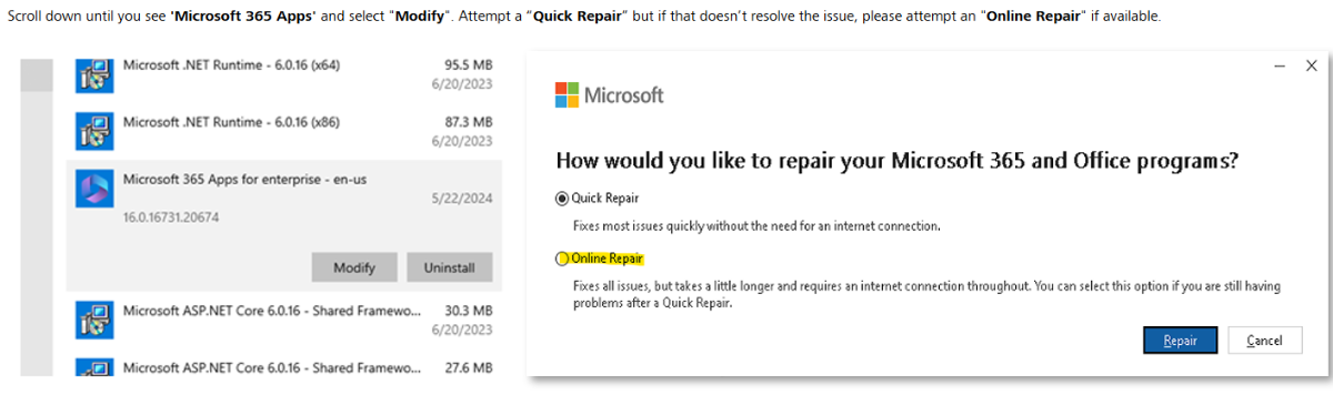

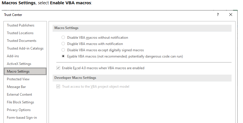

[Ch...] Posted Wednesday at 12:30 PM Share Posted Wednesday at 12:30 PM Please reference this guide for troubleshooting steps. CALYPSO / EXCEL: Error100: ReportINI and Template Troubleshooting Guide Typically I see the most success with steps: and Microsoft 365 Apps Online Repair. Link to comment Share on other sites More sharing options...
