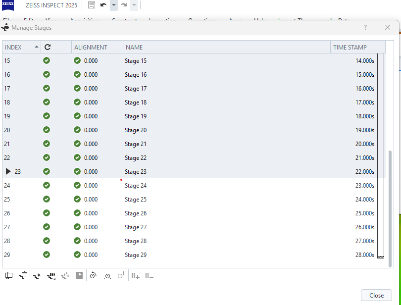

[Fa...] Posted September 6, 2025 Share Posted September 6, 2025 Hello, In preparation for doing a 2D strain analysis, I would like to change the default time step (1 s) for all stages (imported as an image series) to match the real time step (0.00005 s) in the experiments. Previously, I have been able to do so by following these steps: "RMB on the time line -> Manage Stages -> Select all stages in the pop up window -> Edit Time Stamp". However, for some reason, I cannot longer select all stages in the pop up window. The normal procedure (1. click on first stage, 2. press and hold Shift key, 3. click on the last stage) does not work anymore. Is this a bug on the software? Is there an alternative way to edit all time stamps simultaneously? I am using the pro version of Zeiss Correlate, Zeiss Inspect 2025.3.1.6 Thank you in advance Link to comment Share on other sites More sharing options...
[Mo...] Posted November 19, 2025 Share Posted November 19, 2025 Dear Fabio, You can select the stages as usual using the standard procedure (1. Click on the first stage, 2. Hold down the Shift key, 3. Click on the last stage) or use Ctrl-A for all stages or Ctrl for each individual stage. All of them work perfectly, as you can see in the picture. If you have a project problem, please contact support. Regards, Mohamed Link to comment Share on other sites More sharing options...
